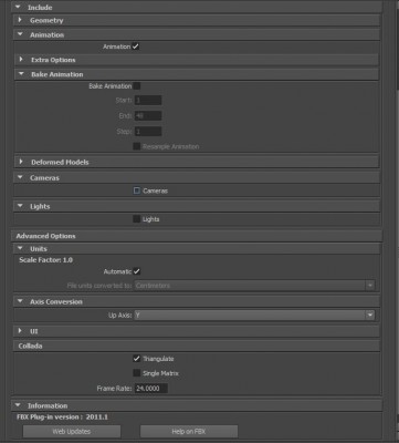

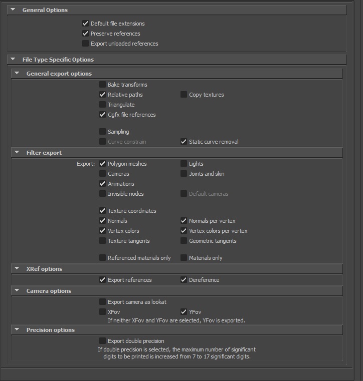

Re: Maya DAE <-> XSI DAE
Hi
I'm also trying to import an animation from maya using the collada format.
I'm using Maya 2011 and have created a simple animation with a plane animating along a curve. the animation has been baked into keyframes for the translation and rotation values. I've tried using both the maya FBX_DAE and the OpenCollada exporter with all sorts of different export configurations....and I still cant seem to get the animation to export into Ventuz....
Ive added some screen grabs of the settings ive been using and the.dae file
any advice would be much apreciated
chris
chris
