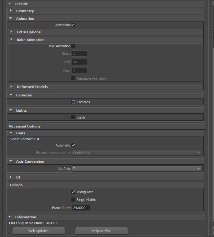

I'm also trying to import an animation from maya using the collada format.
I'm using Maya 2011 and have created a simple animation with a plane animating along a curve. the animation has been baked into keyframes for the translation and rotation values. I've tried using both the maya FBX_DAE and the OpenCollada exporter with all sorts of different export configurations....and I still cant seem to get the animation to export into Ventuz.... :?:
Ive added some screen grabs of the settings ive been using and the.dae file
any advice would be much apreciated :)
