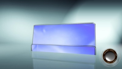

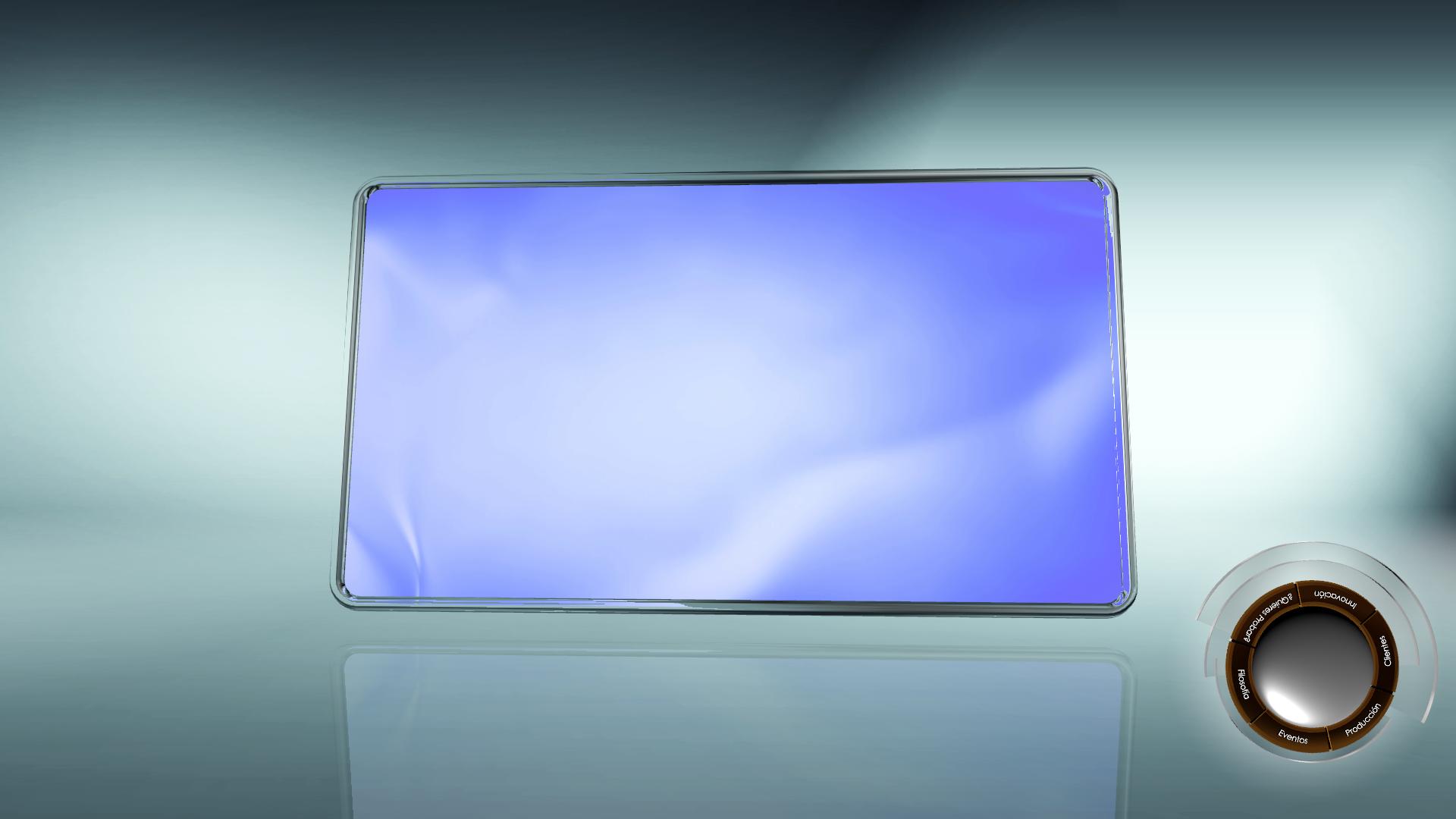

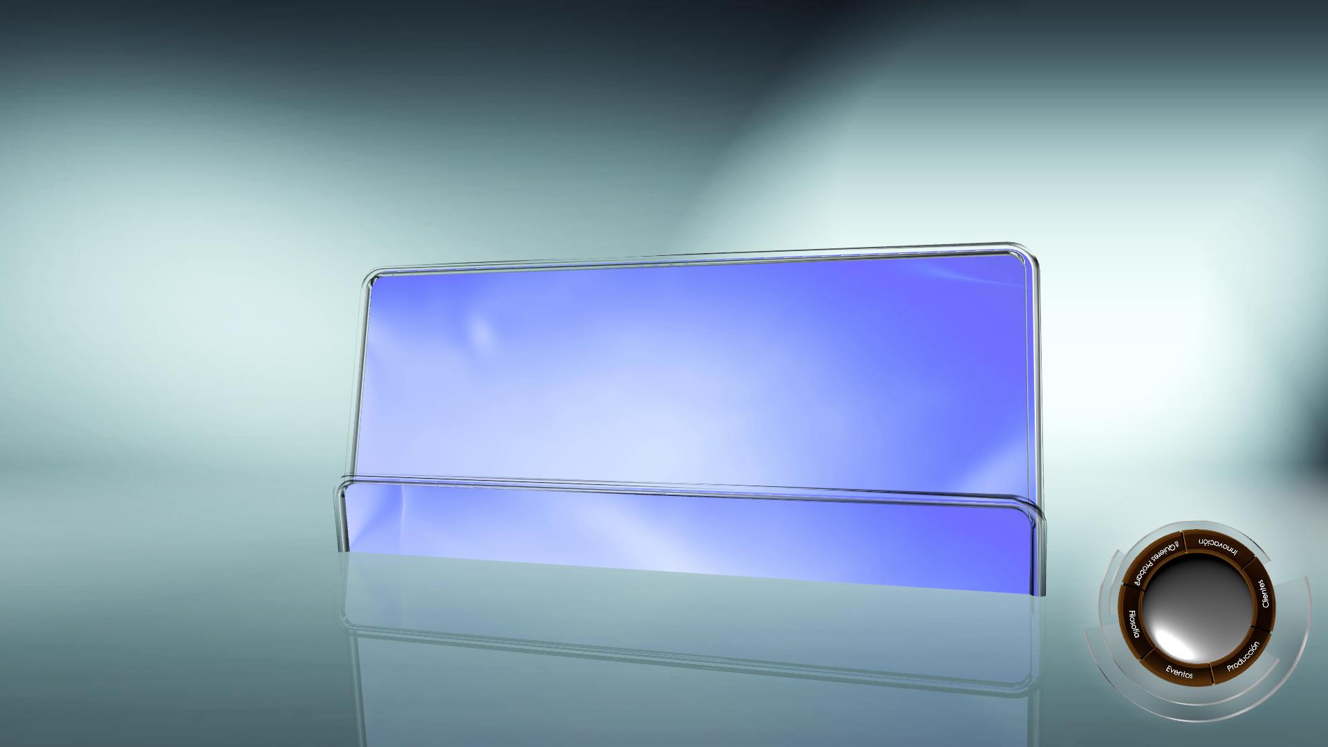

I'm gonna follow Alex's advice and post a couple of images here:
As you can see, the reflection looks great, but when my content goes beyond the wall, the content and the reflected content collides...
Is there a way to avoid these, making the top content only visible on the upper side of the floor, and the reflection only visible on the lower side? Did I make sense this time? :?
