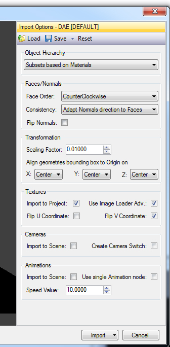

Make certain you are exporting collada from C4d with triangle mesh not N-Gons. I have no problems with baked textures with this setting in Ventuz:-
Regards
Peter

Hey guys I also use C4d sometimes and run into the issue that the v texture coordinates are flipped in the collada file.
So just try to flipp the V-coordinates during import into Ventuz.
