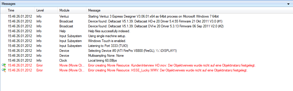

Yesterday i used one of our V-Boxes for a show with a lot of movie files - everything was fine.
But today the same system doesn´t play any videos with the mca-node (see Attache error-message)!
I have already reinstalled Ventuz - without success.
Any Ideas?
m
Movie Clip Advanced error

So, what changed beside the day?
Is it still the same scene with the same Ventuz version on the same hardware?

Re: Movie Clip Advanced error
The only thing that changed is that the v-box has internet access in the office
and get´s some windows and antivir updates...
After the first re-install of 3.06.00 i tried it with 3.06.01 without any success.
Hi Karol,
the ffmpeg DLL´s are located in the Ventuz Folder...
this sounds familiar to me! i had the same a couple of days ago, actually no node pointed at the file the error message was about.
also i had some problems when changing the filename and importing a new (changed) movie with the same filename as one that was already imported. i always got an error when tryin to replace the file. quite uncommen though and can be fixed by simply renaming the new file
I have the same problem as mmahoni.
Someone found a solution ?
