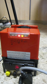

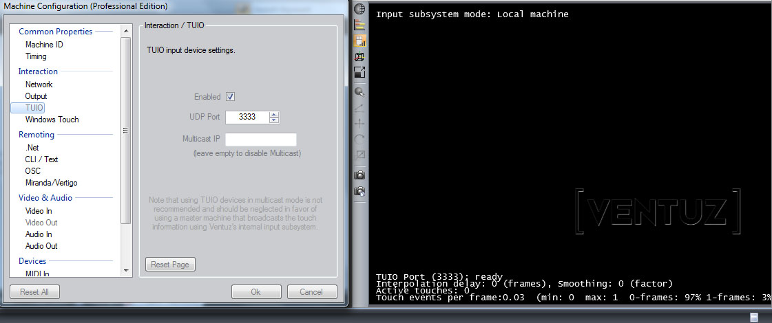

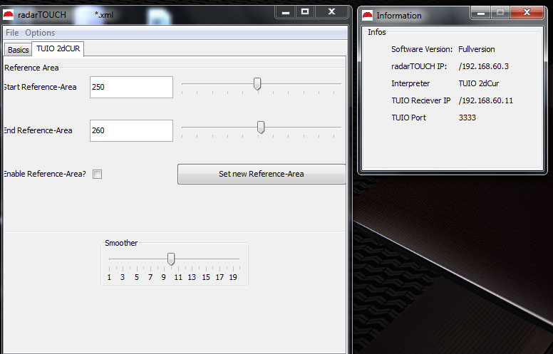

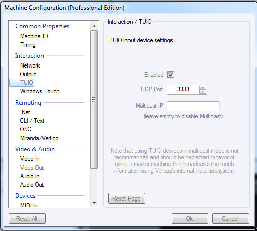

I've checked radar touch with the test program MultiBlobviz 3333, and it works, but when I use it with Ventuz not receive any information.
I attach two photos with Ventuz and RT settings and one of the lights that shine in the hardware.

Post by TobiTobsen » 13 Apr 2012, 20:58
You are Using an old radarTOUCH software version, please send us a mail to info@radar-touch.com. We will send you an update.
