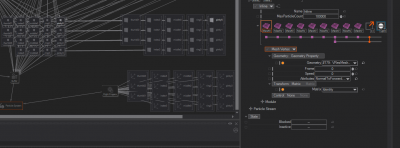

So I had an issue with the Mesh vertex in particle system..

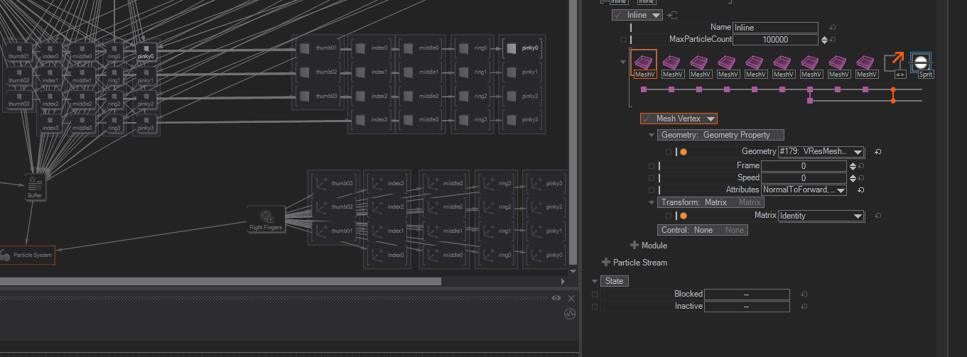

I'm loading almost cube like mesh here so polycount is very low. and regardless of the mesh I load this has a limit.

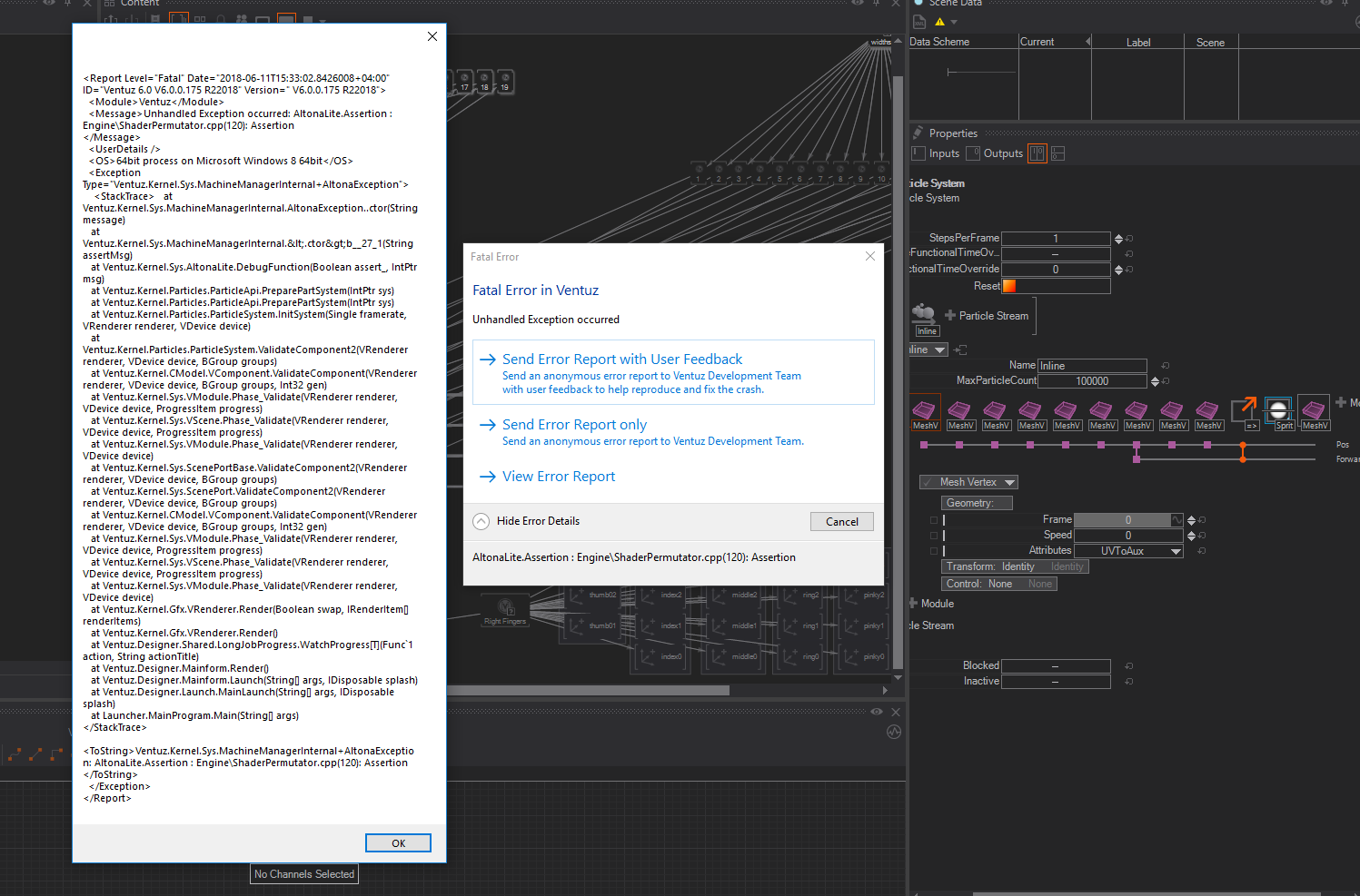

If I add more than 9 Mesh Vertex Modules here Ventuz Crashes... also happens if i add 9 in one stream and 1 in another stream
I'm trying to track multiple meshes and I wanted them all to emit particles. is there a limit to how many mesh vertex modules that can be added into a particle system? if thats the case, I hope there can be another way of having multiple mesh vertex modules (in a way more efficient than adding so many modules) could there be a Mesh Array loader?

Thanks for your Feedback,
will be fixed for the next update
