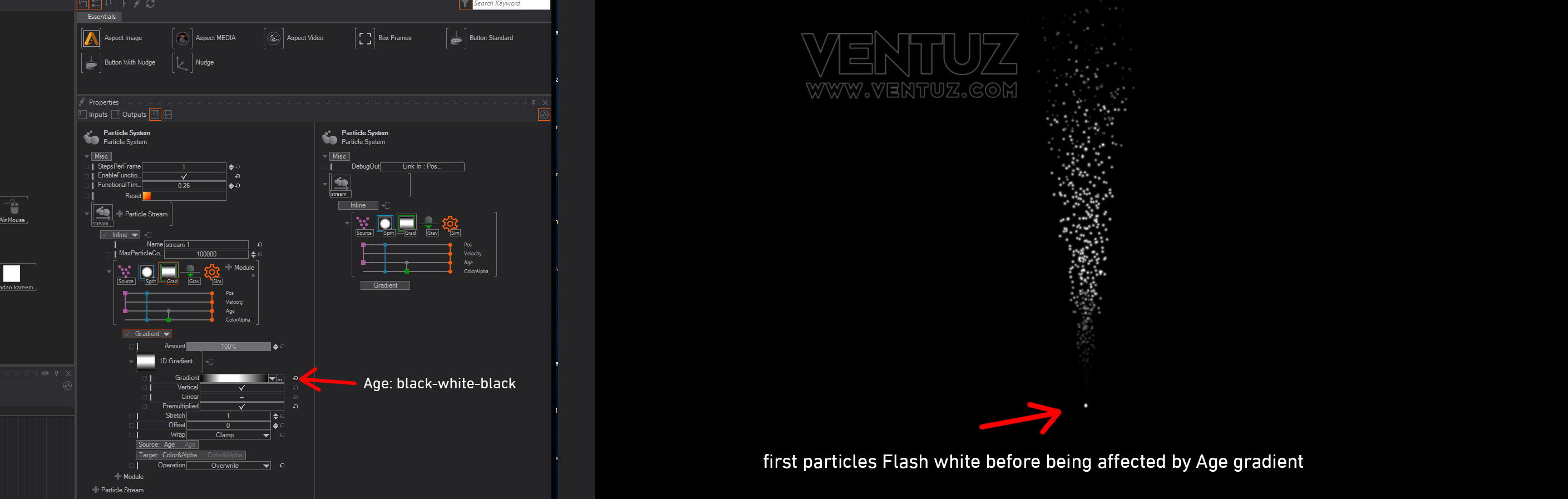

Hi guys.. Just have a small issue..
I want the particles to emit starting 0 alpha and fade in with age.. it works with the gradient, but it just flashes for a frame before the gradient takes its effect on them.. so basically every particle flashes white when it appears then goes 0 alpha to 100 to 0
is this a bug?
Particles Age Gradient

Hey,
basically we made a mistake and did not explain the system good enough (excuse me, it is really complex):
it is not meant to have a SPRITE/RENDERER INSIDE a simulation loop. basically you would just put the sprite renderer after the simulation loop.
In your case, the very first frame, renders a sprite (white flash) next frame THEN colorizes it.
But you want to: Emit, Colorize, Simulate, Render it
