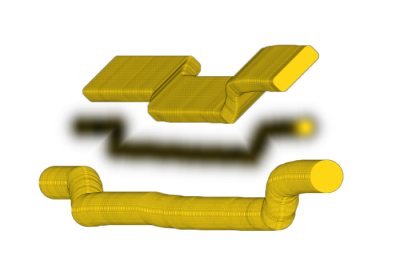

I want to use custom brush textures with the Touch Paint Node, but when I uncheck the Additive property the edges are dark. When Additive is checked, the color gets more white with every paint layer, so that does not help me either.
I tried to make textures that have either opaque or transparent pixels like these 2 ones on the left, but the result is the same. These textures are saved as PNG by the way.
Here is an example of what a yellow brush looks like with different textures.

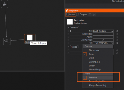

You probably would need to set the "Hint -> Alpha .. to Preserve":

Post by schub » 17 May 2017, 17:10
Thanks Dee, that reduces the dark glow, but it still has a weird behaviour if you cross previous lines, especially if they have a different color.
And a dark glow is still present. I will post some pictures tomorrow.

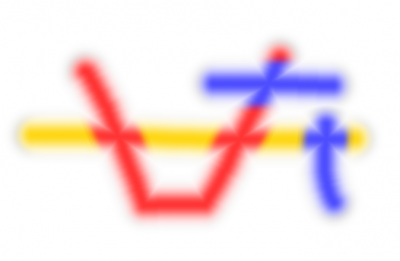

These cross shapes appear at the intersection of different lines, even if they are the same color.

Re: Touch Paint - Custom brushes have dark edges
Post by Dennis » 18 May 2017, 12:14
Yep! confirmed...
Happens as soon as you use a Texture for the TouchPaint.
I created a Ticket for it and lets hope its fixed in the 5.3.1 release (i can not promise).
Sorry and Thanks
