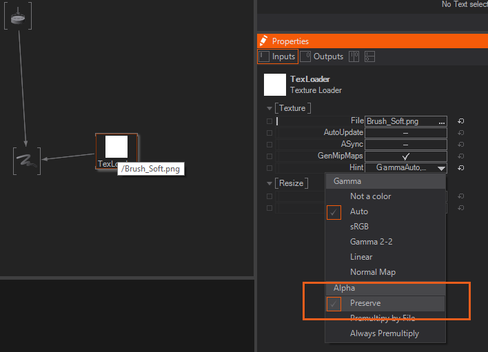

You probably would need to set the "Hint -> Alpha .. to Preserve":

Thanks Dee, that reduces the dark glow, but it still has a weird behaviour if you cross previous lines, especially if they have a different color.
And a dark glow is still present. I will post some pictures tomorrow.
