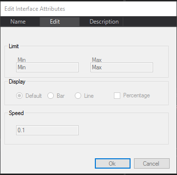

in Ventuz4 there was an option to set default parameters for min/ max etc. in v5 the inherit checkbox is gone ;)

Post by Karol » 03 Jun 2016, 14:07
Mine is still there!
Can you post a screenshot?
The Expose dialog did not really change in V5.

Post by chriss0212 » 06 Jun 2016, 08:33
And here it is ;)

Post by Karol » 06 Jun 2016, 09:19
You are talking about exposings on Interface Containers!
No changes from V4 to V5 here neither.
Is it possible that you compare exposing on normal Containers in V4 with exposings on Interface Containers in V5?

Post by chriss0212 » 06 Jun 2016, 10:48
in V4 it works ;(

Post by Götz_B » 22 Jun 2016, 16:10
it doesn't work if you try to set it for an interface container. But it works for normal containers AND it works on a Interface Container when you adjust it BEFORE you made the container interfacing,
Same in V4 and V5.
If you wanna know why.... we have to wait for Karol again :D

Post by chriss0212 » 05 Jul 2016, 11:19
But if i uncheck interface and try it... still doesn't work. It only works until the container is set to interfaced first time.

Post by Götz_B » 06 Jul 2016, 11:20
Chris.... ähm.... no?
When I uncheck interfacing it works for me (with the latest release). Are you using a different Version? Do you want me to send a screen capture? :D
