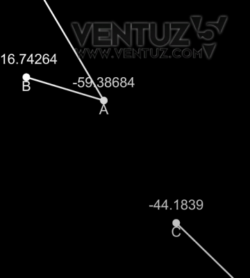

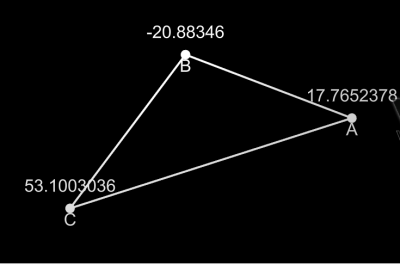

Post by kberraho » 05 May 2016, 21:07
So here is what I have so far, if you see in the picture, I have accomplished the look I was after thanks to the Ventuz community, what you see in the picture are random points A,B and C, every point moves randomly in space on a 2D level, and they are all connected with theses lines in between, the only bug i have is that whenever the A B or C cross on the X axis the alignment changes from left to right giving it a wrong alignment,
Note this only happens in the X axis, and not the Y. THANKS.

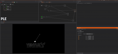

Hi everyone,
i tried to follow the instructions, but i can't get this working.
Can anyone upload a example Scene with two movin dots which are connected through a single line?
Thanks in advance!
T_Gabrielsen
Posts: 2
Joined: 10 Aug 2017, 13:27
Re: Connected Lines in Ventuz
Post by T_Gabrielsen » 11 Aug 2017, 06:35
After a lot of trial & error i finally got it working.
