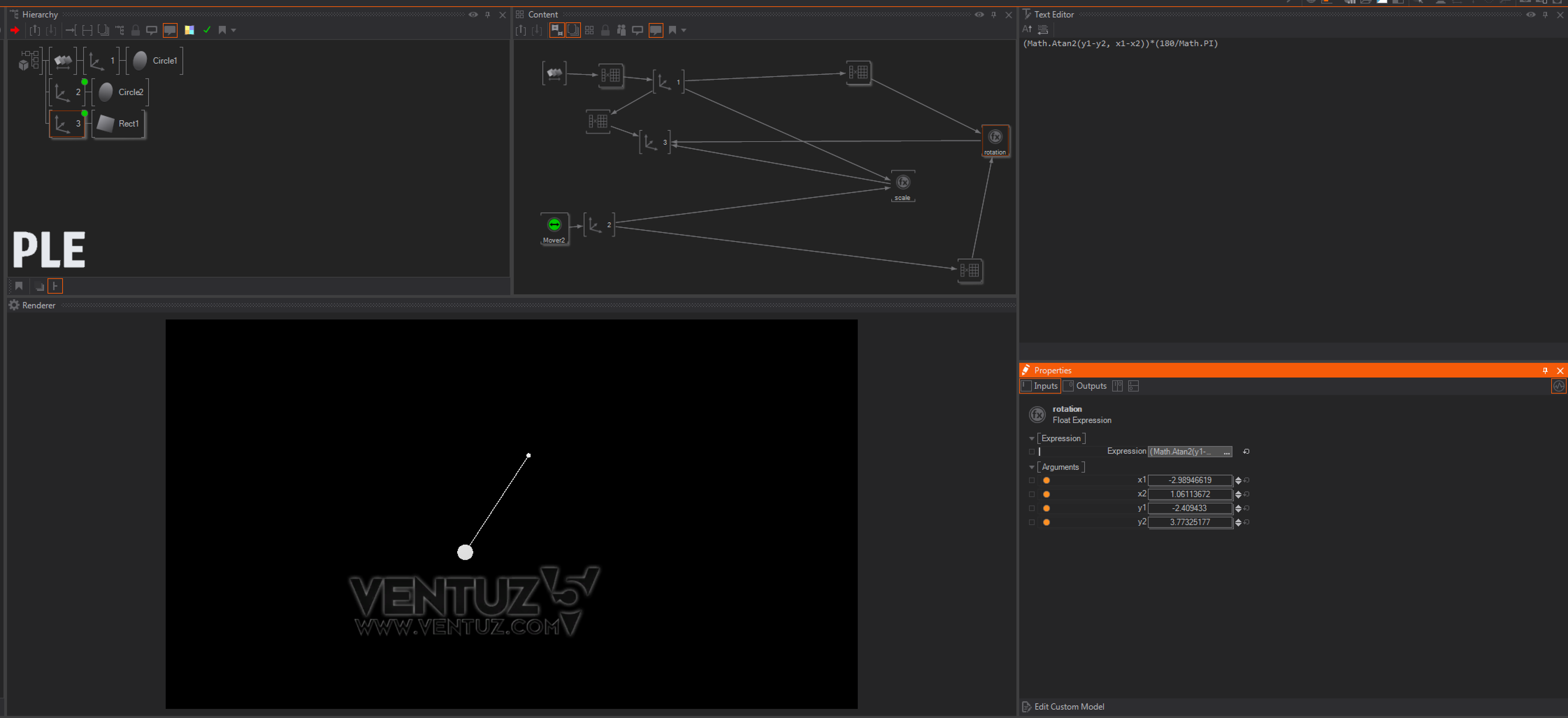

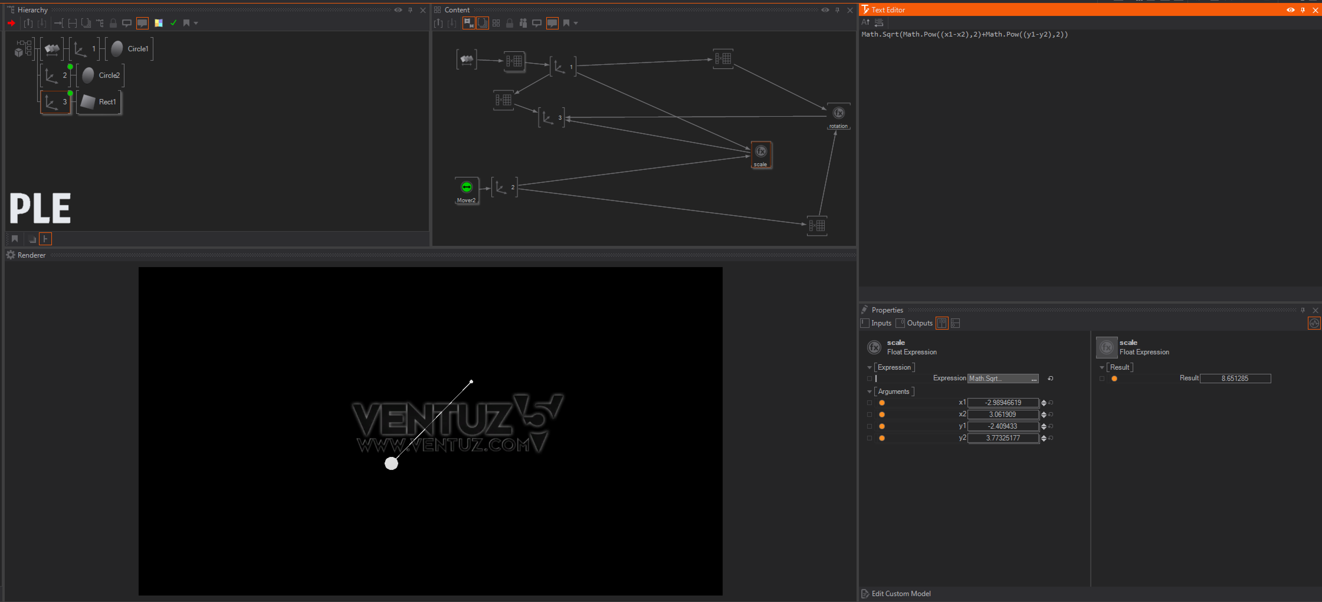

Thank you very much hummerbaendiger,
I followed your train of thought and seems to make sense all the way until the section where the atan2 is supposed to give you the rotation of your object.
Just to make sure I am on the same page as you are, when you mean atan2 you mean the inverse of the tangent?
what node am i supposed to use on this step? I tried the float expression node. with this expression Math.Atan(x1-x2, y1-y2)
So far this is what i have in my scene,
Axis1(0,0,0)>>>>Circle node with a size (0.5,0.5)>>>>Axis2(5,5,0)>>>>Circle node with a size (0.5,0.5).>>>>Get world
Axis3(0,0,0)>>>>Rectangular with size (0.05,6.5)
in the Content window i hooked up the Get world to a Vector Transform node.
Axis1 and Axis2 are both hooked to the Float Expression node to compute the angle.
Any assistance would be much appreciate it. Thank you

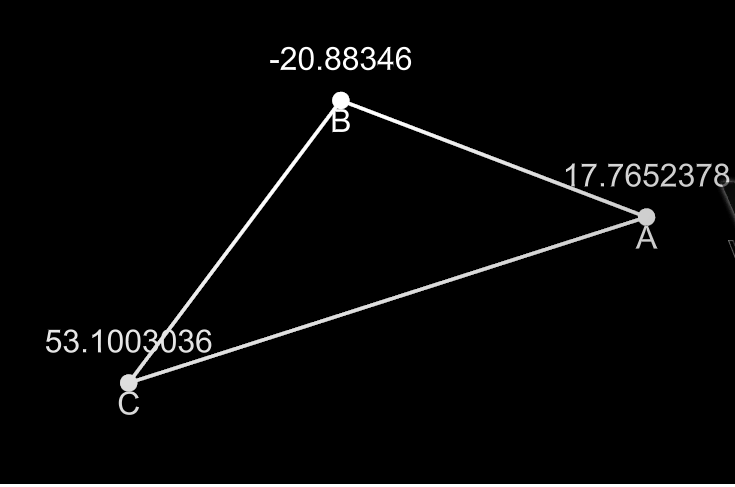

Re: Connected Lines in Ventuz
So here is what I have so far, if you see in the picture, I have accomplished the look I was after thanks to the Ventuz community, what you see in the picture are random points A,B and C, every point moves randomly in space on a 2D level, and they are all connected with theses lines in between, the only bug i have is that whenever the A B or C cross on the X axis the alignment changes from left to right giving it a wrong alignment,
Note this only happens in the X axis, and not the Y. THANKS.
