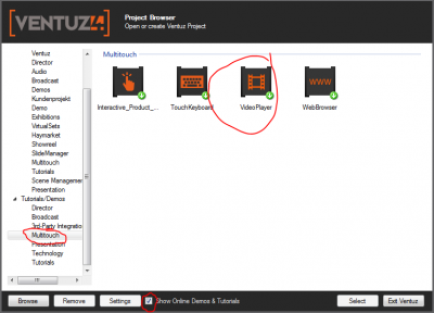

Did you check out the VideoPlayer project from the Online Content? See image!
