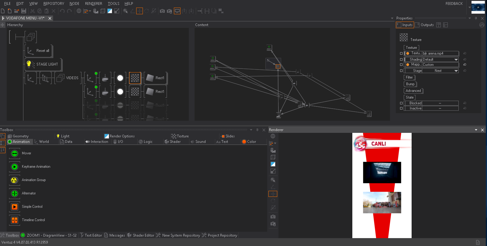

So now my question, in our company my boss asked me if i can design a basic background and have 4 videos like thumbnails and resizing them into fullscreen in each press of thumbnails(videos).
I know the basics and making slides, addin some keyfrae animations, adding videos in each slide but where i have problem is animating something like this.

Hello again. I have another trouble now. I made about 4 videos resizing on touch and playing them sepaeratley in each touch. But i cant stop them when i want to scale down and play the other video.
I tried everything from seek single tap button to pause tap and hold. But nothing worked for me.
How do i stop the video when scaling down? Please help me.

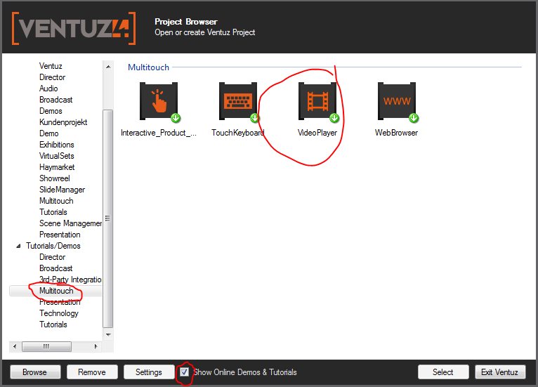

Hi!
Did you check out the VideoPlayer project from the Online Content? See image!
