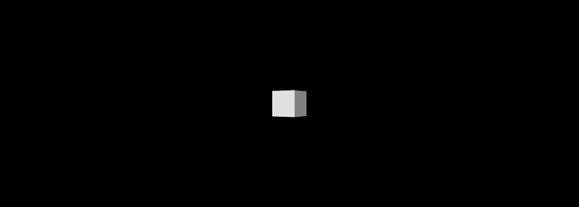

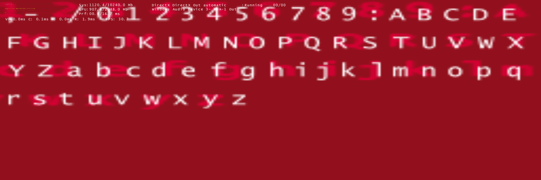

I met a strange problem when I update ventuz from Ventuz4.02 to Ventuz4.03. When I open the statistics in Ventuz4.03, the screen become so strange, I upload the screenShot. So do I need to change some config?

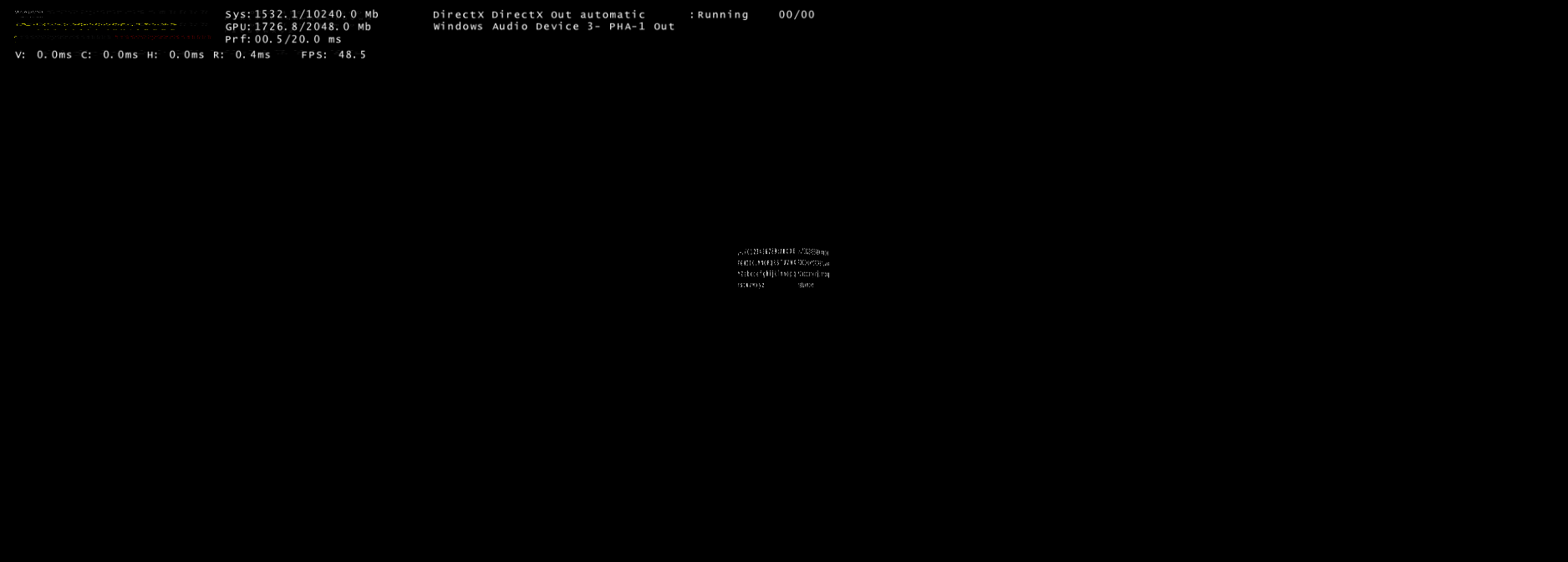

But do you meet the problem when open the performance statistics? It is so strange, I tested 4 computer and 2 of them have the problem.
In the scene, it just an axis and a cube.Before I open the statistics it is OK
But once I open the statistics, it will become like this

No. I never had that behavior before. Looks like the performance statistics is also applied as an alpha mask to the cube and the statistic bars. Very strange indeed.
What graphics card(s) are you using in your systems? Are they the same on all four machines?

This is pretty strange! It looks like the Render-States stack is corrupted and the Font Texture for the statistics rendering is applied to the cube.

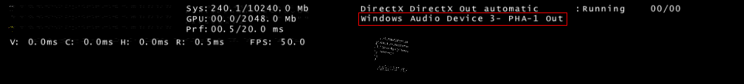

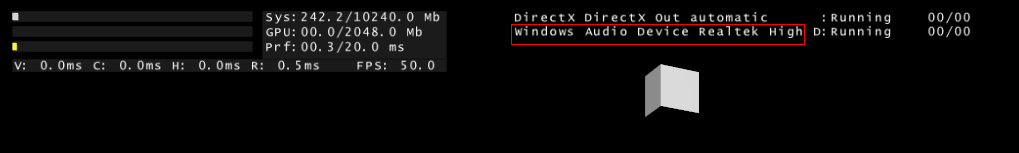

It's really really a strange problem. I found that if I use a USB Independent sound card, I will have that problem. But once I use the motherboard sound card it's no problem.
I use sony pha-1 usb sound card. I don't know why the sound card will influence the Render. Unbelievable.
