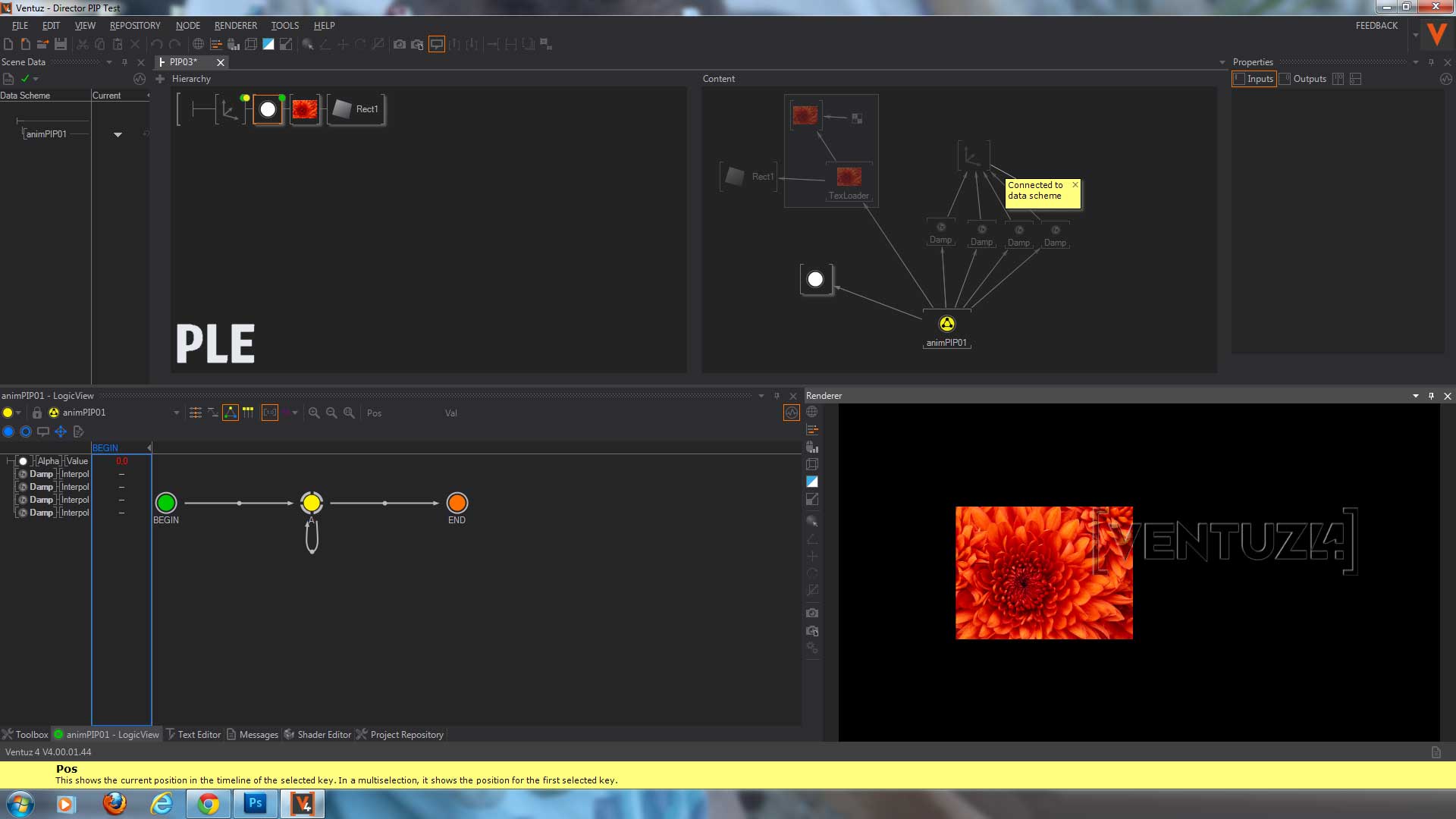

Re: Multi channel for templates
Alex,
I found my way with this little template concerning the automatic position interpolation. Used with the multi-channel features I think it will works very well. R
- PIP03.vza
- (22.85 KiB) Downloaded 1216 times
plkmarudny
The problem with a data marker and in general the way templates are handled is that animating between two values is not possible, only a hard cut. This is a serious limitation I am afraid. What if I want not just to move a picture like in the scene attached to this thread but also make a transition between both old and new values? A simple fade for example.
