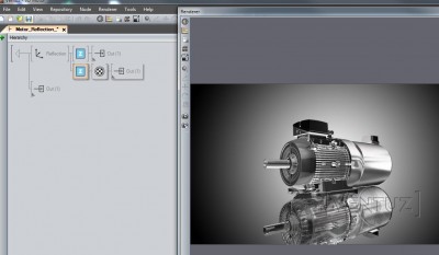

I have an object and want it with a reflection.
If I modify the alpha it becomes transparent in a way that you can see the inner structure. How to avoid this? Thanks.

Render the reflection model at full visibility into a Render Target. Display that using an overlay rectangle and a texture. Fade this rectangle and you have a decent reflection. And with a Simple Blur Texture node if can even blur the reflection slightly if you so choose.

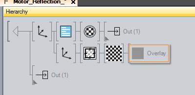

What it´s wrong or do I miss? (see screenshot)
P.S.: Don´t understand your "...without putting any color into the framebuffer"
Why should I - guess the color is on every object itself???

Here is a little example that uses the RenderTarget and SimpleBlur to create a reflection. There are a lot of different ways and tricks you can use. I also added a BumpMap to the reflection as an example. Maybe this help and gives you a few new ideas.
