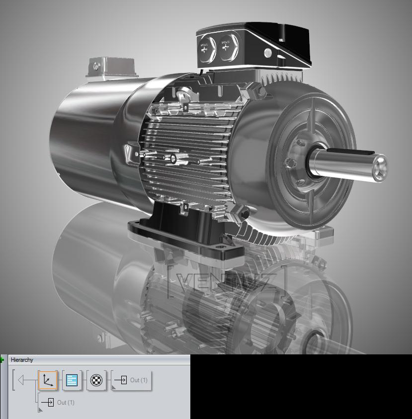

I have an object and want it with a reflection.
If I modify the alpha it becomes transparent in a way that you can see the inner structure. How to avoid this? Thanks.
Cheers Marko

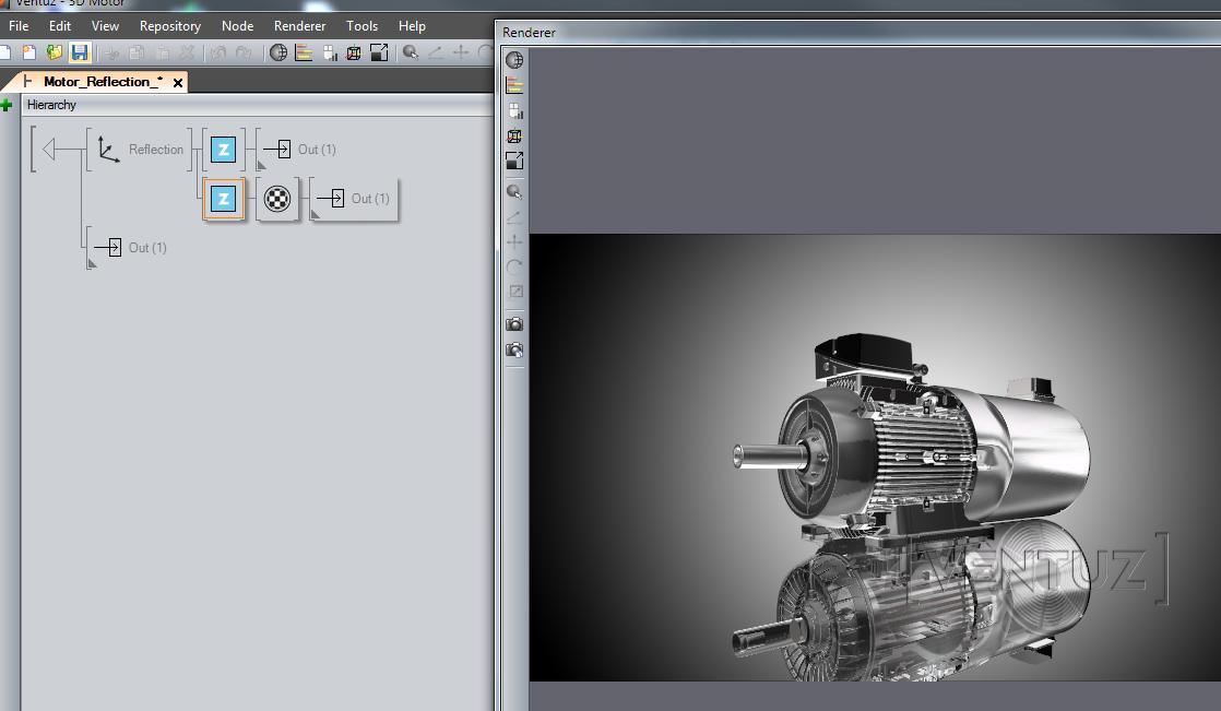

Hi Alex + Christian,
I guess I do not have enough experiences to bring your suggestions to work without a further impulse of you.
@Alex
What it´s wrong or do I miss? (see screenshot)
P.S.: Don´t understand your "...without putting any color into the framebuffer"
Why should I - guess the color is on every object itself???
@Christian
I studied the overlayrectangle example in the Help - but couldn´t transform it into my situation.
General - beside the reflections - the next would be a shadow at the floor - not sure which of both concepts is better for that.
M.

Post by Christian Krix Schmidt » 05 Aug 2013, 14:43
Here is a little example that uses the RenderTarget and SimpleBlur to create a reflection. There are a lot of different ways and tricks you can use. I also added a BumpMap to the reflection as an example. Maybe this help and gives you a few new ideas.
Chris
