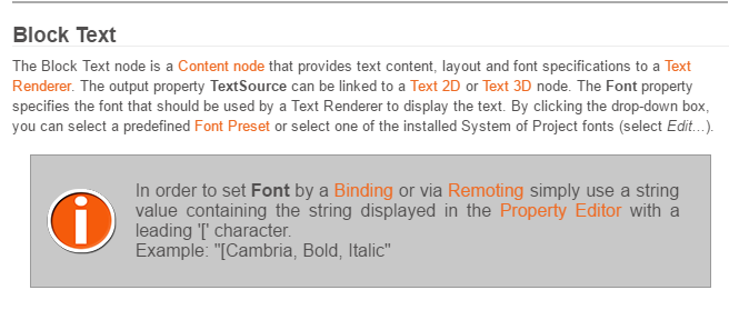

Further to my font explorations. I cant get this
to work by using the "[" (left bracket)to change part of the text to Italic.
There is no example in Ventuz Help!

Hey,
just check out this VZA.. maybe it helps a bit :)
Enriched_Fonts_DD.vza
(7.82 KiB) Downloaded 417 times
I created a "Font input Property" called one WingDings. For the Property i did chose "[wingdings, Bold, Italic".. as soon as it is pasted it will show as "wingdings, Bold, Italic"
just use the <WingDings> tag where you want it to have the different font or style and close the tag </WingDings> where it should end...
enjoy :)

Post by joysprod » 30 Jan 2017, 17:17
Got it!
Thanks
