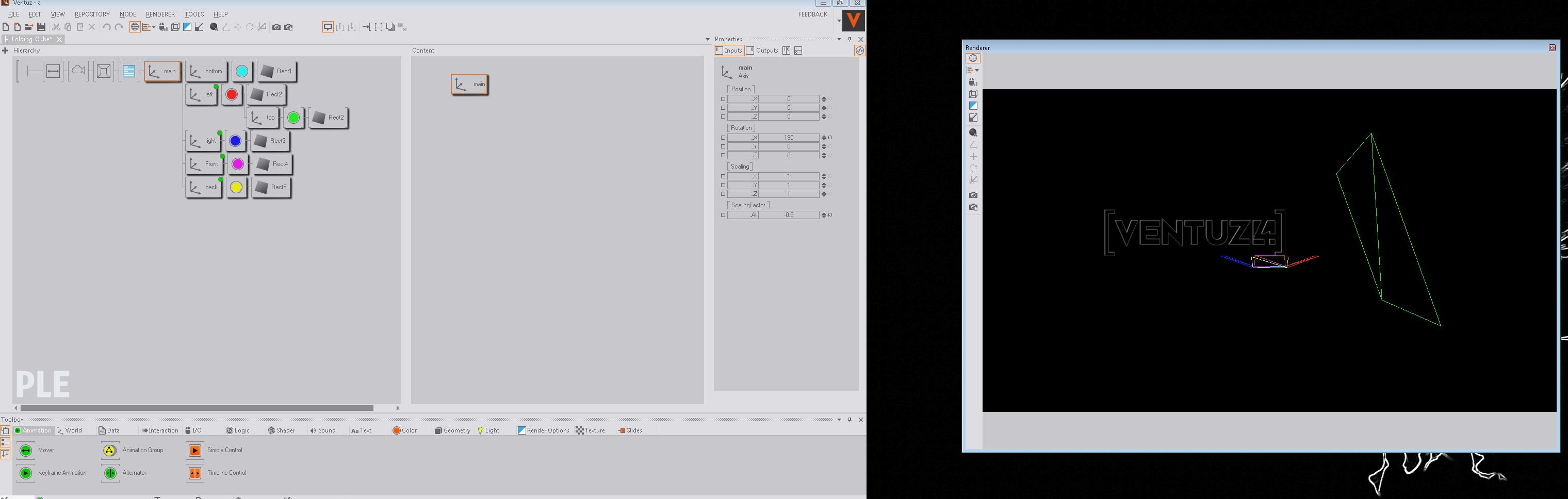

hello guys
well i make two rectangles and i want to make connection between them as parent child connection so i can use them in animation together as folding sides
but when i drag the child node to the parent node the model pop out the model postion and scale changes ????
what to do ????
objects scale problem
