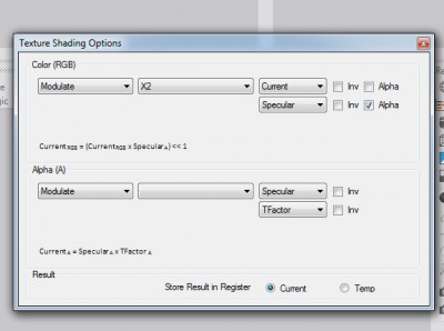

I am very new to Ventuz, but I am finding some of the procedures easy to do, except I am having some trouble controlling textures.
I am trying to texture this inhaler. I have used a Ambient Occupation UV map from C4D to give fake shadows on the device, and have also used 2D plastic texture to help give it some plastic reflections..
The trouble is that the plastic map, overpowers the shadow map, it and looks very fake looking, even though there are lights in the scene.
All I really need is for the plastic map to blend a little with the OA map so that it mixes a bit better. I have tried the blend modes in 'Add' 'Add Smooth' and also the custom settings in this dialogue box, but there is no opacity control.
I have been using a 16bit PNG texture and experimenting with a RGBA file with photoshop, IE using a extra channel. But as yet this does not work.
I noticed that there is shader panel, and low an behold a 'Texture Mixe'r node. I would guess it works by linking attributes into the texture? It appears, unintuitive as I see it at the moment.
Is there a tutorial available? The options I am currently using seem very restricted.

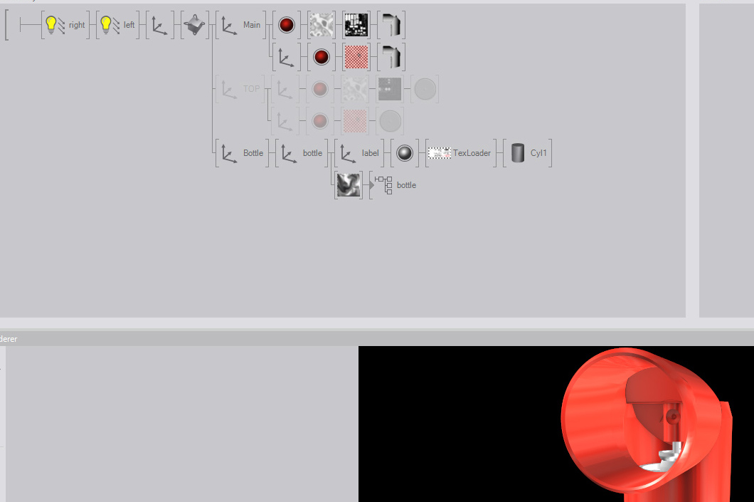

Could you post this small scene tree (as an archive VZA; File -> Export -> Scene Archive) so we can take a look on the texture shading settings.

As Karol said, post up a scene archive and we can take a look ;)

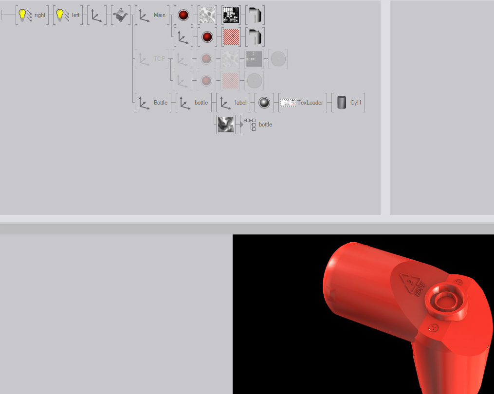

I did improve my render through trial and error. I found that duplicating the mesh with a plastic texture onto a different axis gave me a bit more control.
Also the custom bending modes helped. It is kind of hard to light this
