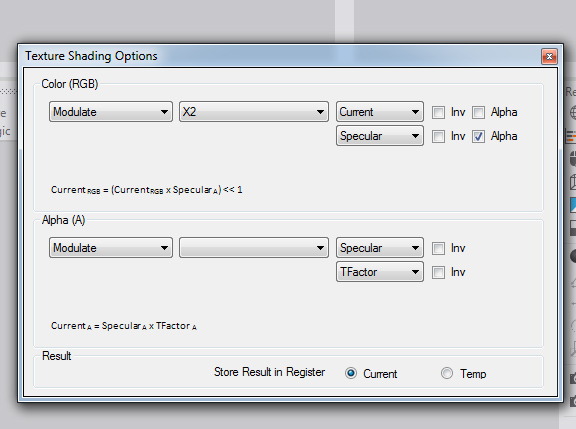

All I really need is for the plastic map to blend a little with the OA map so that it mixes a bit better. I have tried the blend modes in 'Add' 'Add Smooth' and also the custom settings in this dialogue box, but there is no opacity control.

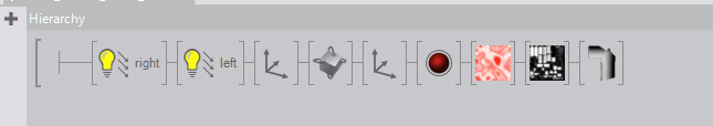

get rid of the lights.
get rid of the material node and replace it with a colour node. (if you dont put a colour node the model will still react to the Ventuz default light)
CTRL-A your red swirly texture for now, but keep it for experimenting later

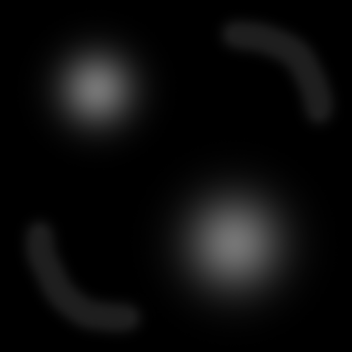

Create a texture (512x512 is fine) in PS or whatever you are using....Black background, with some soft feathered white brush work in it. (some spot, some lines...get creative just not too much for now)
save the file (as a DDS if you can. PS has a plugin available from nvidia to do this)
Add it in as a new texture in your tree and set the mapping to sphere map. (this essentially fakes a bit of lighting, thats what real time is all about....backdoor methods

Re: Mixing textures
In fact here you go a 10 second master piece
.....png is fine for your tests

I did improve my render through trial and error. I found that duplicating the mesh with a plastic texture onto a different axis gave me a bit more control.
Also the custom bending modes helped. It is kind of hard to light this
