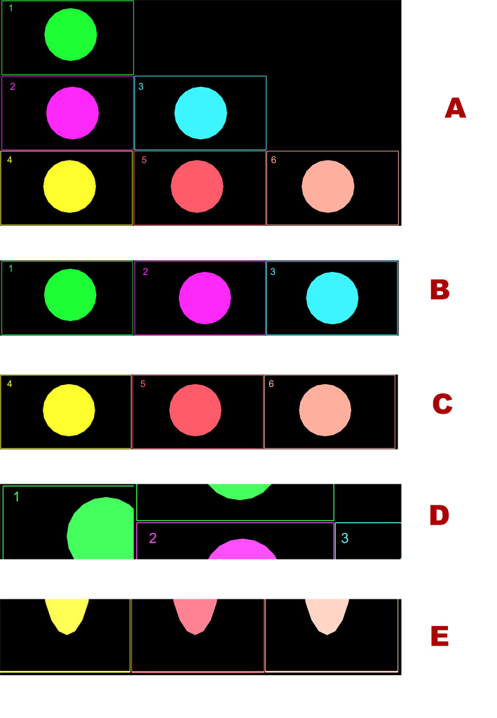

I have a design I am working on with two machines giving me a total of 6 outputs...
All is fine if sending content straight to screens, As in AB&C
If I use a Render Target from the content, my outputs are completely wrong as in D&E
I have fixed this by re-mapping the individual polygons according to the machine ID, but was wondering if there is an easy fix I am missing using Viewport & Projection nodes? ? I realise that the aspect of machine 1 & 2 is not the same, and was wondering if that is what is throwing it out?

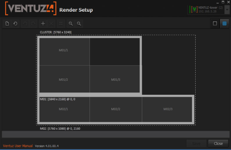

there are some Nodes that need some extra attention when using the Render Setup.
http://www.ventuz.com/support/help/late ... itiveNodes
Just set the ScreenAligned property of the Render Target from inherit to no.

Thanks Götz
I thought it was there somewhere! Was looking in the wrong place in the manual. Easy when you know how!!!
