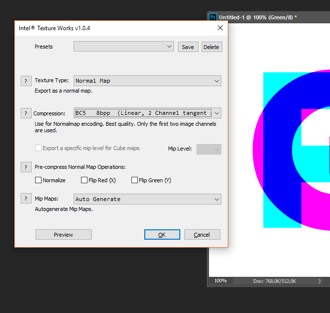

See the following images to get an idea how to use the RG DDS Texture with the Texture Components node and assign the channels ...
Create a Texture with only Red and Green Channel painted/Filled:
Use the Intel Texture Works plugin to select and save as BC5:
Preview of the resulting Texture:
Texture Components used to assign the R Channel to the left and G channel to the right rectangle (in both cases to the base color):
