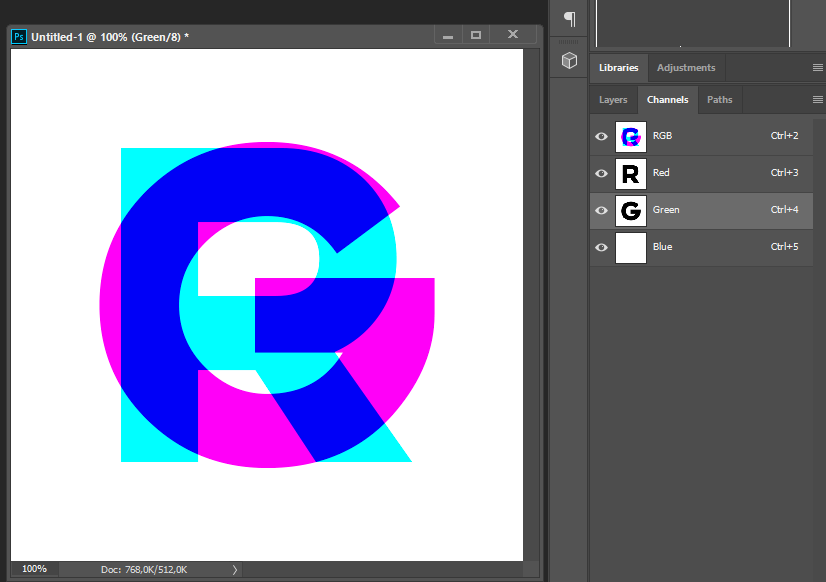

Create a Texture with only Red and Green Channel painted/Filled:

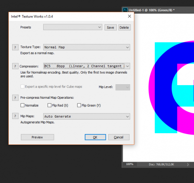

Use the Intel Texture Works plugin to select and save as BC5:

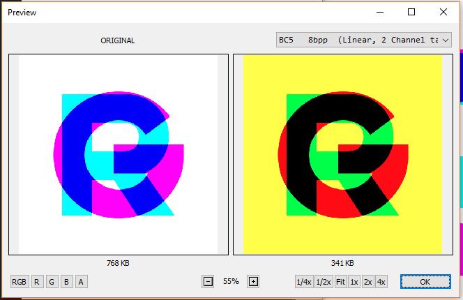

Preview of the resulting Texture:

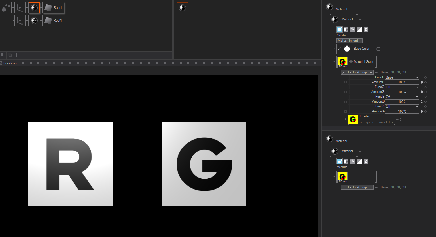

Texture Components used to assign the R Channel to the left and G channel to the right rectangle (in both cases to the base color):
