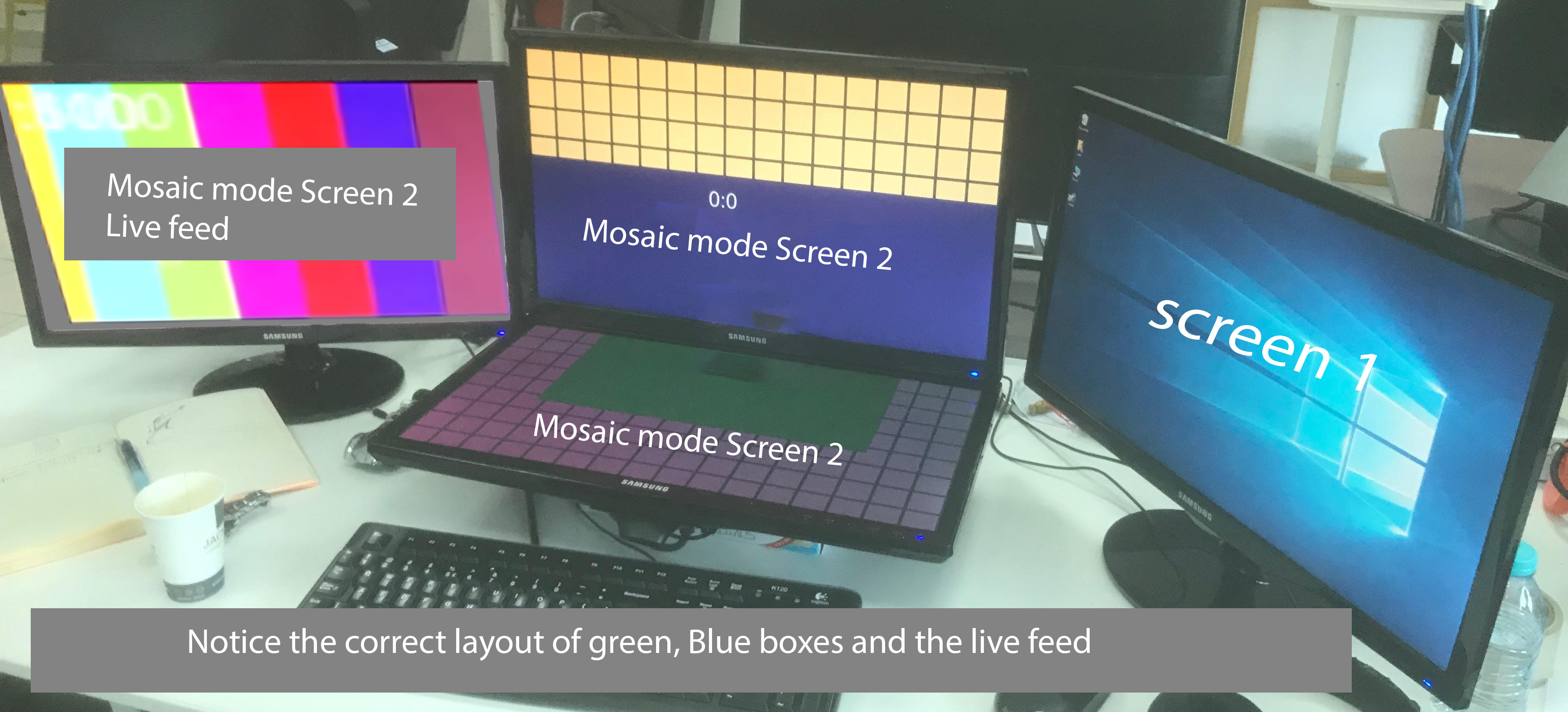

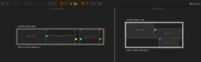

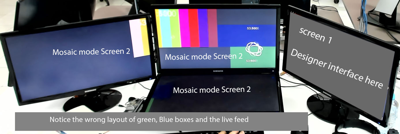

<t>The setup:<br/>
I have 4 Displays FHD size 1920x1080.<br/>
3 Screens are Mosaic setup<br/>
<br/>
The Problem:<br/>
when working in Designer with Full screen render view I get wrong layout although the Configuration is enabled in Stage Editor.<br/>
when exporting to VPR and run, the layout works perfect.<br/>
In Designer the layout is following the Mosaic setup mode which have all screens aligned horizontally.<br/>
but VPR is following Ventuz Layout Configuration.<br/>
<br/>
Please check attached images for better illustration.</t>

Hi Ghandi,
Designer always starts in 'Cluster Design Preview'!
See manual: https://www.ventuz.com/support/help/lat ... tml?itm=70
Best Regards
Best Regards
