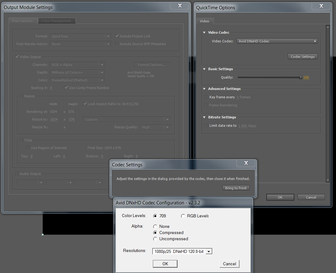

I have done this a lot before, not using QuickTime Pro though. I've made DNxHD clips with After Effects with the attached settings and played them in Ventuz with alpha. However, I tried a clip just now and it seems to ignore the alphachannel. I brought the file into after-effects again to verify that the alpha channel is in fact present in the clip, and it is.
Something happened in one of the latest releases?

Which node are you using in Ventuz to play back the clip? The new Advanced Movie Node uses an implementation of ffmpeg to decode movies. Maybe ffmpeg does not support alpha channel of the dnxhd codec. Have a look here: http://en.wikipedia.org/wiki/DNxHD_codec
Alternatively you can always use the Quicktime Animation codec to play back RGBA footage.
Chris

Karol, I'm sure I've used DNxHD codec with alpha before, however it was on my 32-bit system (that I no longer have available).
And I'm not entierly sure, but I think it was under the Quicktime node I used it... sorry for the bad info!
Maybe we have to be sure we have the same version of the Codec-package from Avid as FFMPeg is using?
All the best from Stockholm,
Sam

chriss, i meant to say that ffmpeg maybe does not support the alpha channel.
it is a bit funny, weird and sad at the same time that your client does not want to use QT animation.
sam, if you used the quicktime node before than it is a whole different story. don't count on the advanced movie node to be able to play back the same codecs. it is not quicktime. if you were to use the 32bit version of ventuz than you can use the quicktime nodes again and the dnxhd codec as before.
