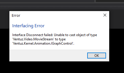

Unable to cast object of type
Posted: 26 Aug 2020, 16:03
by davidkmiller
Ventuz Fail to Cast error.PNG (6.52 KiB) Viewed 7112 times
Seeing this while trying to send a texture through a scene port. After this error it breaks the exposed attributes that i have exposed from the scene port.

Hi David,
can you post a simple scene so we can reproduce it here?

IT seems when i connect with a regular texture it works fine but if i do movie stream node I get the cast error. I was able to reproduce the error in this file it happens after I connect the textures then go to save the error comes up once for each connection it also gave the error when i was creating the scene archive.

Thanks David,
I can reproduce and fix it for V6.7.3.
