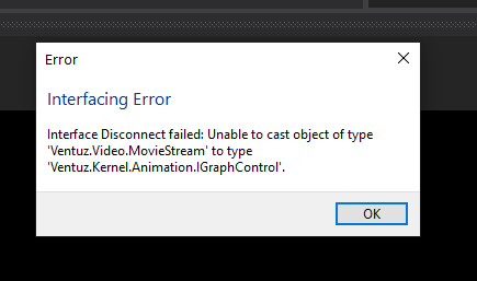

Post by davidkmiller » 26 Aug 2020, 16:03
Ventuz Fail to Cast error.PNG (6.52 KiB) Viewed 7107 times
Seeing this while trying to send a texture through a scene port. After this error it breaks the exposed attributes that i have exposed from the scene port.

Post by davidkmiller » 27 Aug 2020, 20:14
IT seems when i connect with a regular texture it works fine but if i do movie stream node I get the cast error. I was able to reproduce the error in this file it happens after I connect the textures then go to save the error comes up once for each connection it also gave the error when i was creating the scene archive.

Post by Karol » 28 Aug 2020, 10:23
Thanks David,
I can reproduce and fix it for V6.7.3.
