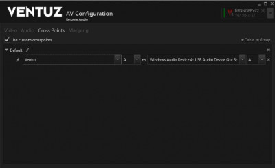

Hello,
it will propably work if you use the Configuration Editor and create a new AV-Config, there you can set a new route/cable for the audio.
Check if that works. Propably you would need to wire "from ventuz to ventuz"
PS: i have just the Ventuz to Windows shwon in the Picture.. you can also use Ventuz to Ventuz!

I already tried this with Ventuz Config but the problem remains...
