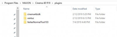

Please create manually a folder somewhere and install the plugin manually there.
Simply copy the files into your Maxon installation folder in the "Plugins" directory...
should look like this:
PS: On one hand you write its about R17 and on your screenshot you show R19.
Would be interesting what version we are talking about!
