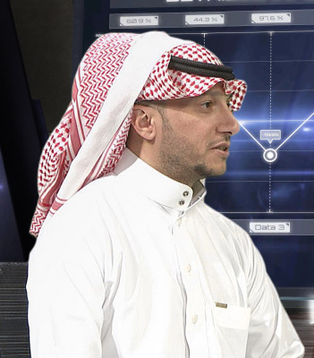

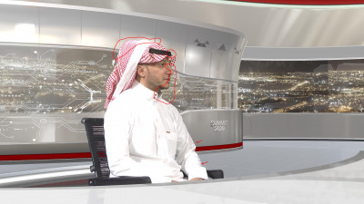

Hi, I've been waiting for a long time to see more will be added to this effect,
what I am asking are three new features to this effect that are crucial:
1- Alpha Choker
2- Edge feather
3- Anti alias for the edge.
I tried to achieve both of these features manually, but it doesn't as it should . .
regards.
Thx in advance

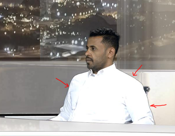

Re: Color Difference Keyer
Here are some demonstration :
other software with the same image:

one or two things looking at your jpgs.
It looks like the footage has been interlaced AND the camera(s) had an additional „sharpening“ active, which might be responsible for the dark edges around your actors.
Youn might consider that and try to have a most uniform greenscreen as backdrop. Make sure to literlly „iron out“ all kinds of wrinkles and folds, edges, etc...
