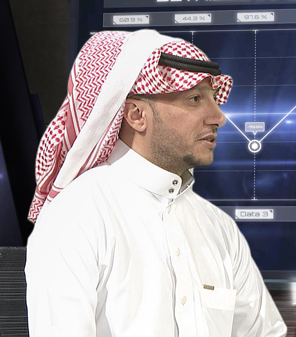

Re: Color Difference Keyer
Here are some demonstration :
other software with the same image:
![Image]()

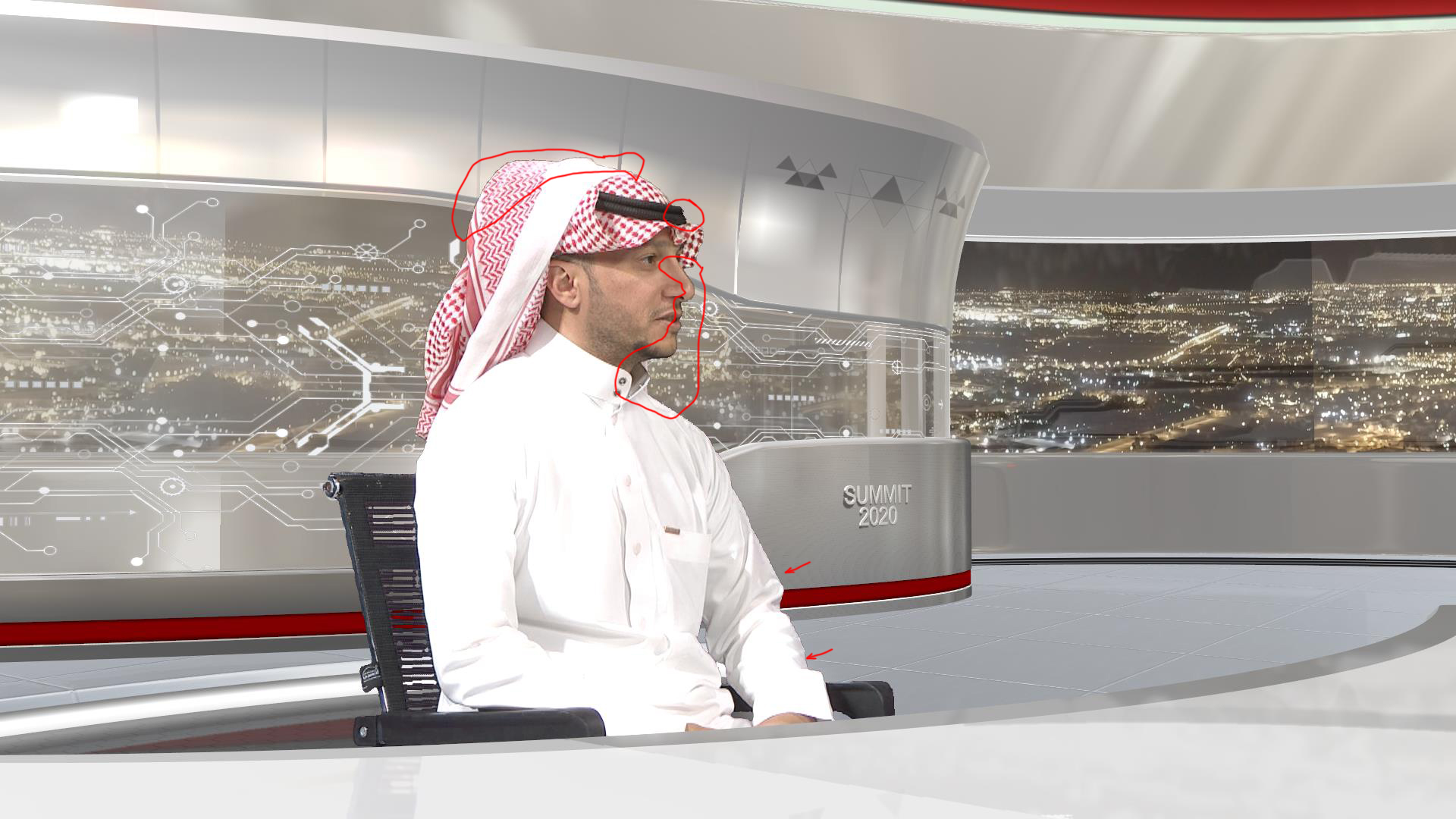

Re: Color Difference Keyer Camerasettings
one or two things looking at your jpgs.
It looks like the footage has been interlaced AND the camera(s) had an additional „sharpening“ active, which might be responsible for the dark edges around your actors.
Youn might consider that and try to have a most uniform greenscreen as backdrop. Make sure to literlly „iron out“ all kinds of wrinkles and folds, edges, etc...
Hi everybody, thx in advance. I already know all of the mentioned solutions, and I'm already doing it. The only thing I'm asking is very very very simple, it may take with Ventuz maybe 1 or 2 days just to add the two things I mentioned. What I'm doing sometimes is as follows: I key the video, the video is as render target, then take it to another layer, inverse the alpha, add an edge and add a small bit of blurring, then a final layer, where I take the keyed layer as the base color and it's alpha inverse of the inversed alpha layer...... But when I have big moves, the inverse alpha is shifting (delaying a fraction of a second, leaving shadow like arteffect....because there are delays between layers, since the main key layer has no post effect and the other one has, Specially if I'm using 3 or 4 cameras.
After all, all I'm asking is helping me just by adding an edge smoothener and an alpha choker to the post effects. Is it that hard to add only those ????????
There are lots of examples of codes how to make alpha choking and edge smooting by HLSL, but I don't know how to make them work in Ventuz.
Please I beg you Ventuz, just add an edge smoother and an alpha chocker in the color difference filter. This is all what I am asking for.
I just can't take it to see that a cheap junk program <$6000 has a keyer that can even key a bottle infront of a green screen . . . it's just not fair. Ventuz is the best software that suites me. But this problem is really making clients get away from doing virtual studio, just because I can't have soft edges !!!! We already lost a very big project just because of such a filter.....
Please just take a look in discord the video I uploaded . . . the key is amazing, even you have the real shadows of the person on the ground ! It's insane. . .
As for the shots, we are already lowering the details of the camera with the CCU.
