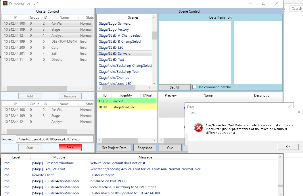

I have a big project for a TV Station. 6 Machines with the current Ventuz version with 12 ports. I've wrote a tool using your Remoting SDK. When I try to cue a template, it works - take - works - clear - problem! After that also the cuing of other templates failes. The error message is:
Cue/Take/ClearGet DataItmes faild: Received TakeInfos are inaccurate (The separate takes of the machine returned different durations)
This only happens, if I have multiple machines in one cluster. If I have only one machine, it works. I also tried with the latest SKD samples, but the same.

I see, that the Remoting.dll from Director is newer than the DLL form the latest SDK but also with the new DLL I've got the same error. Because I'm just using the default project "Remoting 4" I think it's not a question of the implementation. It's allmost happen after the first take. If I cue two templates without a take in between, there is no error. If I'm using only one machine per cluster (so I'm using 3 machines with 3 cluster for testing), it works fine.
