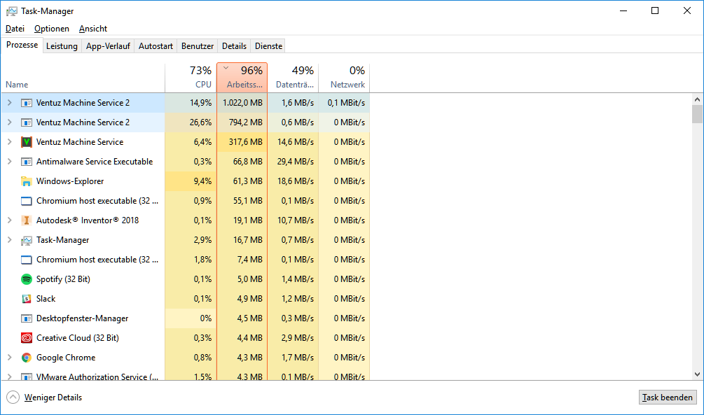

I only have this issue on my office workstation so it might be related to the machine.
But when I leave the PC ideling for a few hours and i come back sometimes (every few days) it is hardly responding
a look to the task manager looks like this... Even though the task manager only shows 1.something GB of ram for the VMS service, all my 16GB are filled up.
After stopping the VMS tasks everything is fine again...
Maybe you have an idea if its Ventuz related or somebody else has the same issue...
Regards, Eric

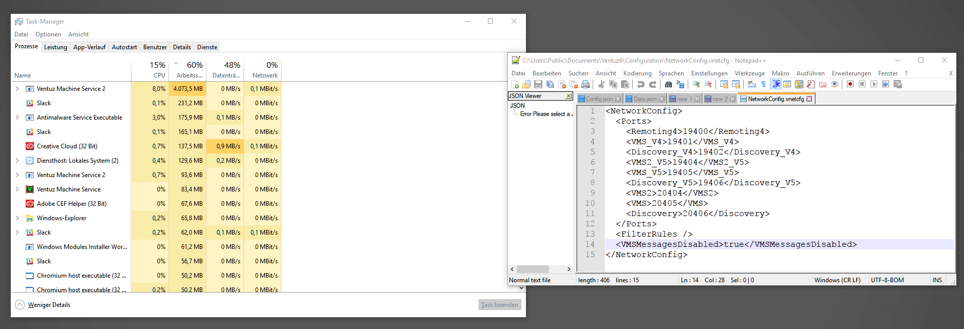

Hmmm
installed 6.1.3, restarted PC after installation, edited the network config and left the PC running over night. (no energy save mode)
This is what I saw this morning...
Re: VMS consuming much RAM
after the changes in the config... did you restart the VMS?
