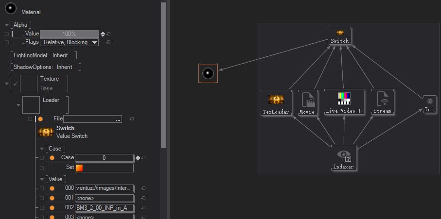

I've done all the steps described in the links above, but it doesn't work. The Texture Uri from ValueSwitch node's Output cannot be passed to the matiral node.
please help~
Thank you very much!

You bound the texture to the file name field. That can't work.
  1. Select your material
  2. Klick on the arrow on Texture Loader
  3. Select Texture Property->Empty
  4. Now bind the switch's output to the Texture property

Problem solved!
@lerou Thank you for your timely help~
