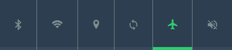

How make this button effect ?
eguana
Posts: 5
Joined: 04 Jul 2018, 19:25
Post by eguana » 04 Jul 2018, 20:03
I have 6 buttons.
When I once click on any button, it becomes active. When I press the second time, the button goes to the normal state.
When I press the button, the other buttons should go into normal state, they must be inactive
How disabled other buttons, i don't know, please help. I use logic toggle, switch, value.
Ventuz scene
