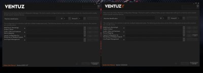

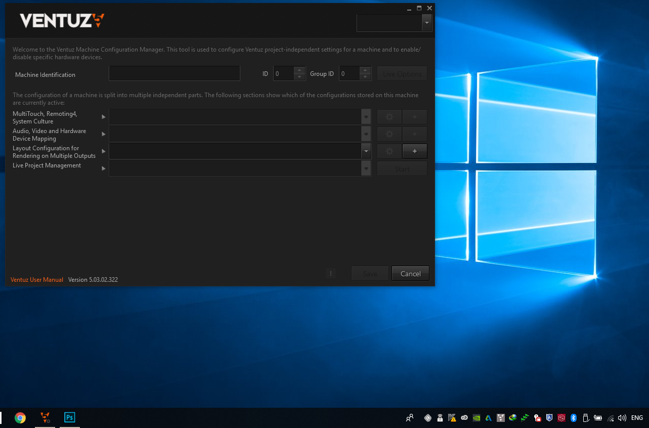

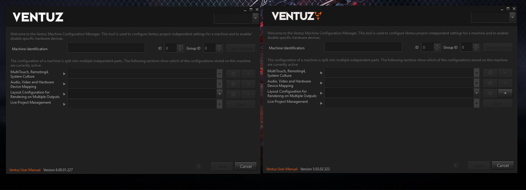

I bought a new laptop, installed Windows 10 pro. The laptop is AUS G701VIK gaming laptop with NVIDIA 1080. When I first installed it all was working fine and I did change the configuration settings. Second day when I opened my laptop, I can no more see anything in the ventuz configuration, also the VMS is grey, there seems to be no connection. This is happenned both for V5 and V6. Same issue on both. I checked firewall, put antivirus off, tried lots of things, nothing worked. The only way it worked is by uninstalling all, erasing Ventuz user settings file from Appdata ....

Please open 'Services' and check if Ventuz Machine Service 2.2 (Ventuz 5) and Ventuz Machine Service 2.6 (Ventuz 6) is running.
These services are needed by the Config Editor to read and write the config files.

Yes they are running. Even I restarted them... nothing works. Only when I connect it to the router, and it finds LAN it works. This is really odd

Latest Windows 10 pro is installed (previously it was windows home, and I thought it's because of that, so, I bought the pro edition). Downloaded at Microsoft 2 days ago, and installed it clean. Everything works fine, just can't change configuration settings... unless I plug into LAN or wireless network, I don't know if finding another Ventuz on the network is necessary or not...

I update V6 to 6.00.01.227 still same issue.
