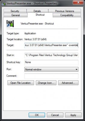

The workaround for the moment is to make a presenter shortcut with the -override command line option.

How do i set up the workaround exactly? Simply adding -override to the shortcut path doesnt work for me.

-ovveride should work. Check if you added a blank after the quotation mark
Code: Select all
" -override
Re: vpr config with win7 64 bit german
i had a blank after the filename in the 'target' path, but there were no quotation marks, when i added them before the path and before the -override, they got removed after pressing OK after i opened the dialogue again.
where would i find the configure option when the parameter is set correctly, in the context window of the shortcut?

i edited a shortcut to the vpr file, so thats why it had no effect.
i can only find the VentuzPresenter.exe in the ventuz installation folder, if i make a shortcut from this and add -override it stays there after saving.
do i need to edit the vpr properties to open with the new shortcut instead of the original presenter.exe?
we dont have any affected machine here at the moment, but i will try this when we get it back.
