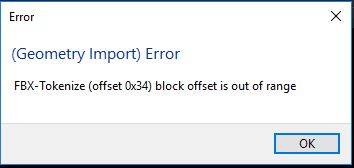

I setup a simple 3D scene and exported it as a FBX2018 File. When I try to import it it comes a error message:
- Error message
- FBX Error.JPG (17.15 KiB) Viewed 17030 times

Yes i did forget to add to the manual to have it at least with: FBX 7.3 (2013) exported...
This is also the version i am using to have a 100% working cross interexchange between all autodesk and other suites...
please try again with the named FBX version and you should be fine..
I tried importing the ball with the animation into C4D and re-exported it with 2013... everything was fine.
Thank you

please make sure to use FBX 2013 (7.3) as export version... nothing else...
The issue is with Assimp and not Ventuz... the same goes for interexchange between autodesk software, the newer versions of FBX have big issues. If you try to use the newer FBX version between maya, max, modo and so on you will encounter issues as well.. except you use the 7.3. Sometimes there is an issue.. sometimes on another feature.. sometimes it works..
But where we (including me as 3DSMax Guru) can be sure is : with 2013 7.3 you got at least
nearly no issues/problems ...
