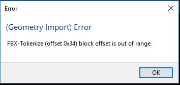

I setup a simple 3D scene and exported it as a FBX2018 File. When I try to import it it comes a error message:
Error message
FBX Error.JPG (17.15 KiB) Viewed 17011 times

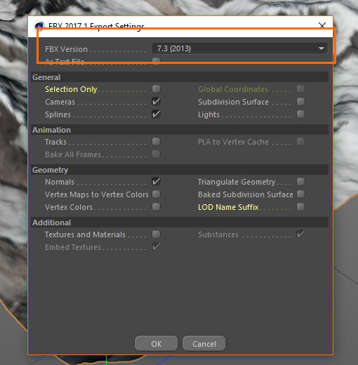

Yes i did forget to add to the manual to have it at least with: FBX 7.3 (2013) exported...
This is also the version i am using to have a 100% working cross interexchange between all autodesk and other suites...
please try again with the named FBX version and you should be fine..
I tried importing the ball with the animation into C4D and re-exported it with 2013... everything was fine.

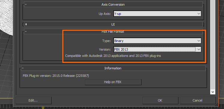

please make sure to use FBX 2013 (7.3) as export version... nothing else...
The issue is with Assimp and not Ventuz... the same goes for interexchange between autodesk software, the newer versions of FBX have big issues. If you try to use the newer FBX version between maya, max, modo and so on you will encounter issues as well.. except you use the 7.3. Sometimes there is an issue.. sometimes on another feature.. sometimes it works..
But where we (including me as 3DSMax Guru) can be sure is : with 2013 7.3 you got at least nearly no issues/problems ... ;)

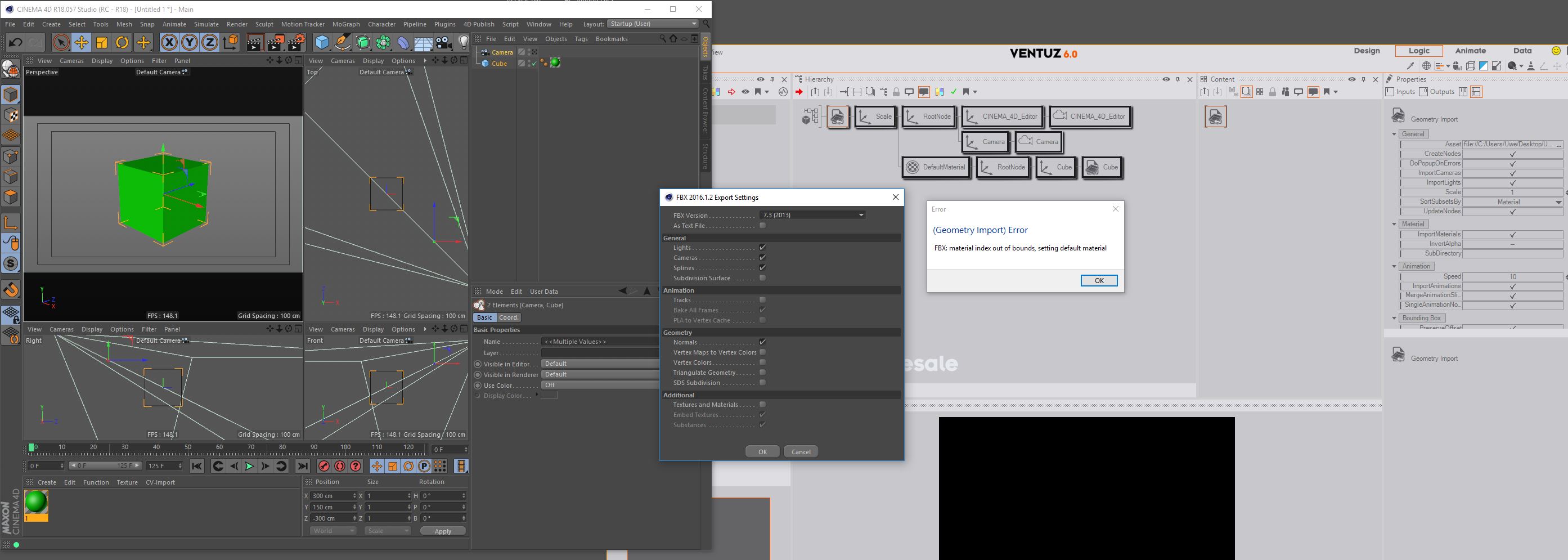

First of all, great that C4D Liove Link works pretty well,
But FBX import does not. At least not for me.
Even a simple cube with a green color as texture does not get imported. :(
Weird enough that FBX 7.3 is last recommended version. I don't know what is going on there with these "standards".
Cinema 4D R18

as soon as you confirm that error message .. it is correctly imported .. right?
also with green color?
if not could you please post the c4d file here ?
thanks
dee
:ugeek:

..Yes and no. I tried it again today. The green color does not come with it. Only when checking textures as well on export.So you could say it works.
But when I have a real texture applied in cinema or even a normal map etc, they dont get imported. I have to find and load them manually.
I get the message "geometry import error - unable to handle scheme of..."
The same file exported as a collada 1.5 (and 1.4) does get imported with the texture, but then again here the uv-mapping seems to get lost.
So I will stick to live-link for now.
