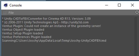

...it seems to me that the windows update is the problem:
cinema console
the geometry server can't start

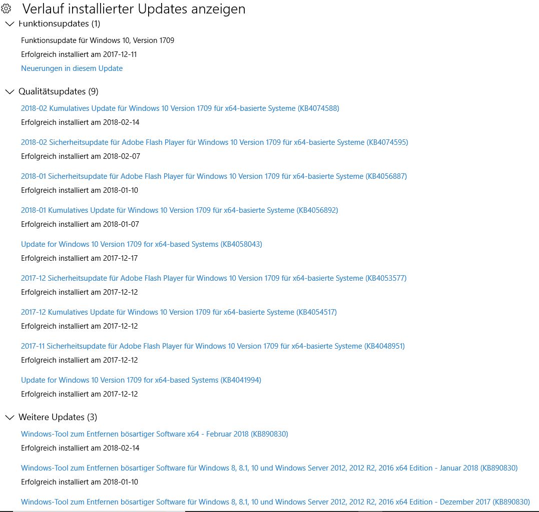

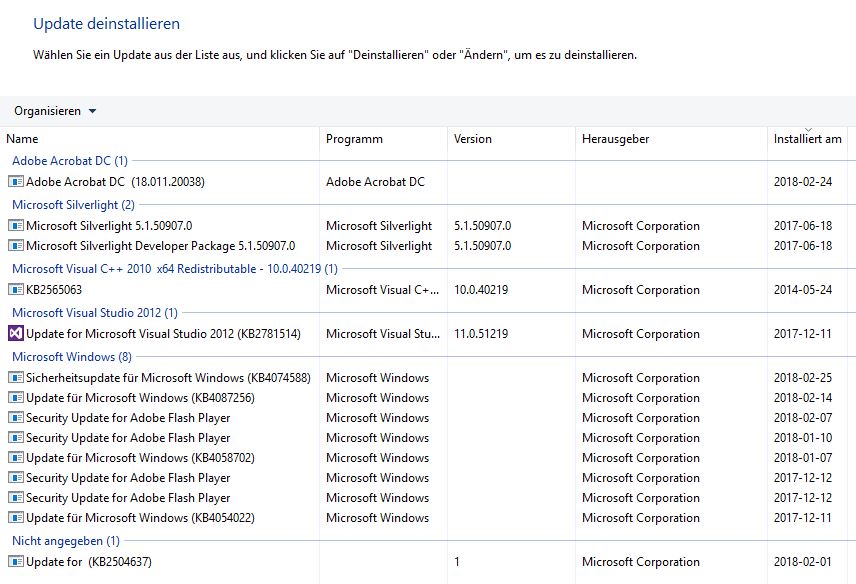

list of updates that can be uninstall
windows updates
