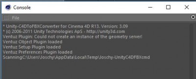

Hey,
please be so kind to check the Properties for Cinema4D -> Ventuz Live Link.. there is a serveradress.. either let it empty, or use localhost or 127.0.0.1
if you checked this and tried everything... please open the console by clicking : Script->Console
it should read in the first line about ventuz: Ventuz Plugin: GeometryServer active...
and 3 times loaded.... vtz object, setup and prefs plugin loaded....
If thats not working at all and the geometry server is still not active... we maybe have ONE "kb" fix from windows to deinstall... Which has accidentally installed in the last months and is preventing several plugins and tools to communicate properly.. as well the ventuz plugin is affected. -.-
This was just the case with my workstation and couldnt be replicated until now.
But hopefully we will find another solution.....
Thanks and regArts

Re: Cinema4D Live link
...it seems to me that the windows update is the problem:
the geometry server can't start

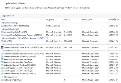

Heyho,
please search for the following KB:
KB4023057
Uninstall and restart the machine, try again to reinstall the cinemaplugin from ventuz and it might work.
Would be really great if you could give it a go.
Thank you very much for testing this.
all the best
KB4023057
all the best

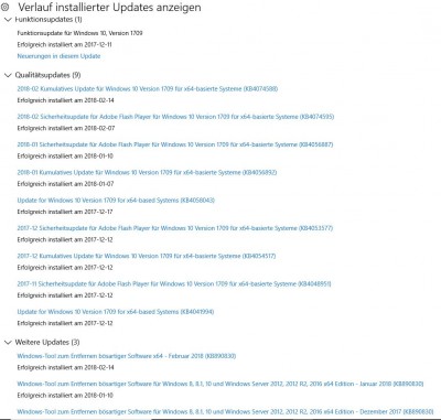

Damn,
that would have been too easy anyways ^^
i just could figure out when it did stop working for me .. and that was around the relasetime in between of january the 6th to february..
i just had a look what kind of KB was installed then (the only changes to my system in that time was the regular windows updates), so i deinstalled the KB which matched the timeframe, which was apparently only the one i named...
ok thanks for testing! i will give dev a hint to have a closer look at this.
thank you very much!
regArts
PS: make sure you reaaaaally deinstalled ALL ventuz plugins from ALL locations of cinema4d (the one under %appdata% and the other inside the program files folder!!!)
