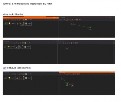

I just started working with Ventuz and am learning with the tutorials.
My question ist for this one: https://www.youtube.com/watch?v=r_t_akb ... e=youtu.be Minute 5:37
Here is a part I just can't do. Can someone please help me out?
I screenshoted it (look at the attachment)

Hey and welcome to the forum!
You need to hold Shift while clicking the Nodes one after another.
In the Content Editor you can see all selected Nodes of the Hierarchy Editor and all nodes connected to them.
