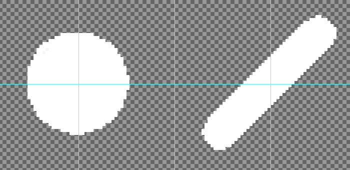

I tried to make textures that have either opaque or transparent pixels like these 2 ones on the left, but the result is the same. These textures are saved as PNG by the way.

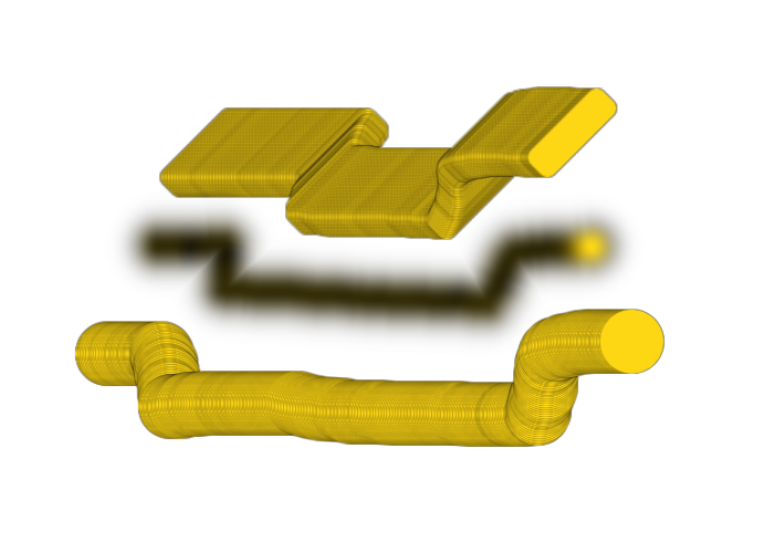

Here is an example of what a yellow brush looks like with different textures.

Thanks Dee, that reduces the dark glow, but it still has a weird behaviour if you cross previous lines, especially if they have a different color.
And a dark glow is still present. I will post some pictures tomorrow.

These cross shapes appear at the intersection of different lines, even if they are the same color.

Yep! confirmed...
Happens as soon as you use a Texture for the TouchPaint.
I created a Ticket for it and lets hope its fixed in the 5.3.1 release (i can not promise).
Sorry and Thanks
