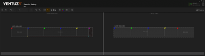

In Config Editor Create a new Render Setup with one Machine 7680*1080 Pixel
slit by cut (Top: 1000, Left 7200) and remove the three small rectangles.
Add another machine with Full HD (split by cut again on the full HD surface if you dont want the dead 80 pixel strip above/below the Production Output) left side: how your actual Graphics outputs look like
right: your "work space"
You project Format shoult be 9120*1080 (or 9120*1000 if you did the second split)

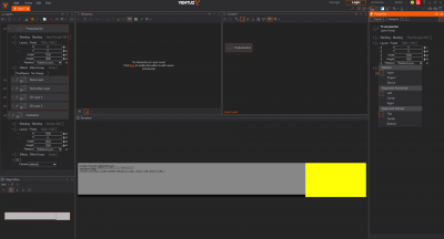

In the Designer create a Layer group with 7200 * 1000 pixels (Pos 0,0, Top Left)
inside this group you can place all the "production layers"
Create another layer outside the Layer group set it to Pixel (1920*1080 (1000), Pos 7200,0,Top, Left) for your Controls. grey=production (machine1)
yellow=control(machine2)
black=unused
et voilà: done.
black=unused
et voilà: done.
