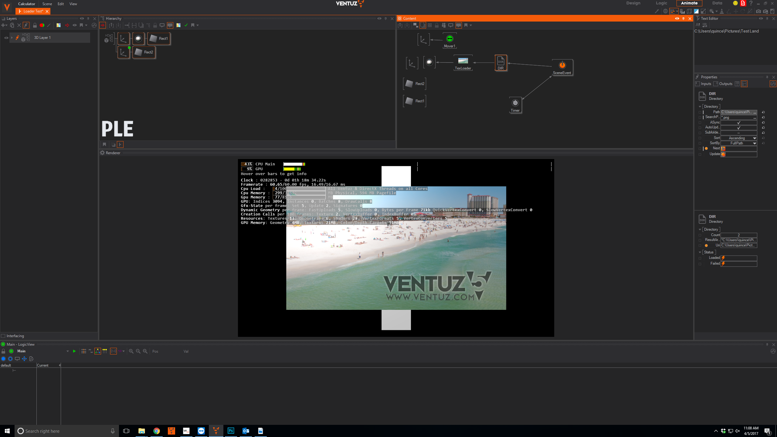

The size of the test scene I have made is 1920 X 1080. The size of the PNGs are 1920 X 1080, uncompressed, not interlaced and are about 8Mb each. They are cropped photos of landscapes. Every 3 seconds the directory loaded loads the next image. I have a mover node connected to a rectangle that slides back and forth so I can tell when the scene freezes. The GPU is running at about 10%-13%. The CPU is running at 30% but spikes to 50% or above when the new image loads. And the frame rate, that is set at 60, drops to about 45fps while the image is loading and right after it has loaded. I attached a snapshot of the scene.
