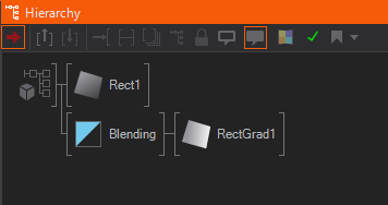

1. Blend inside the same Layer: Use the Blending Node (it is placed in the Render Options Category). It will be applied to all following objects in the Hierarchy and change their blending onto all other objects of the same layer. In the screenshot below the Blending Mode is applied to the Gradient Rectangle, which means that it's color will be dodged linearly onto the rectangle above.

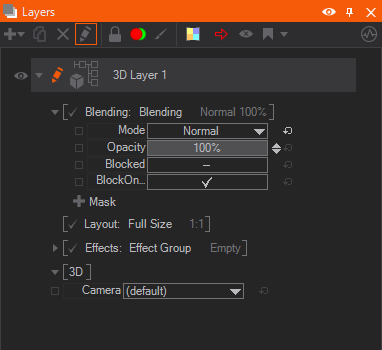

2. Blend onto other Layers: This is only possible Layer-wise and not Object-wise. Use the Blending of the according Layer.
