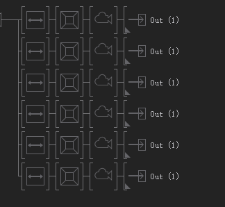

Hi
I find if I use 6 projection and vieweport nodes,each with an output node to link with my scene, the green part of cpu and gpu statics will be very long.
Is that means the scene render 6 times?
Best,
Damon

Post by lerou » 18 Oct 2016, 10:21
yes, it is rendered several times. If you want to tile the very same content (no differences in projection etc.) you should use a rendertarget.
